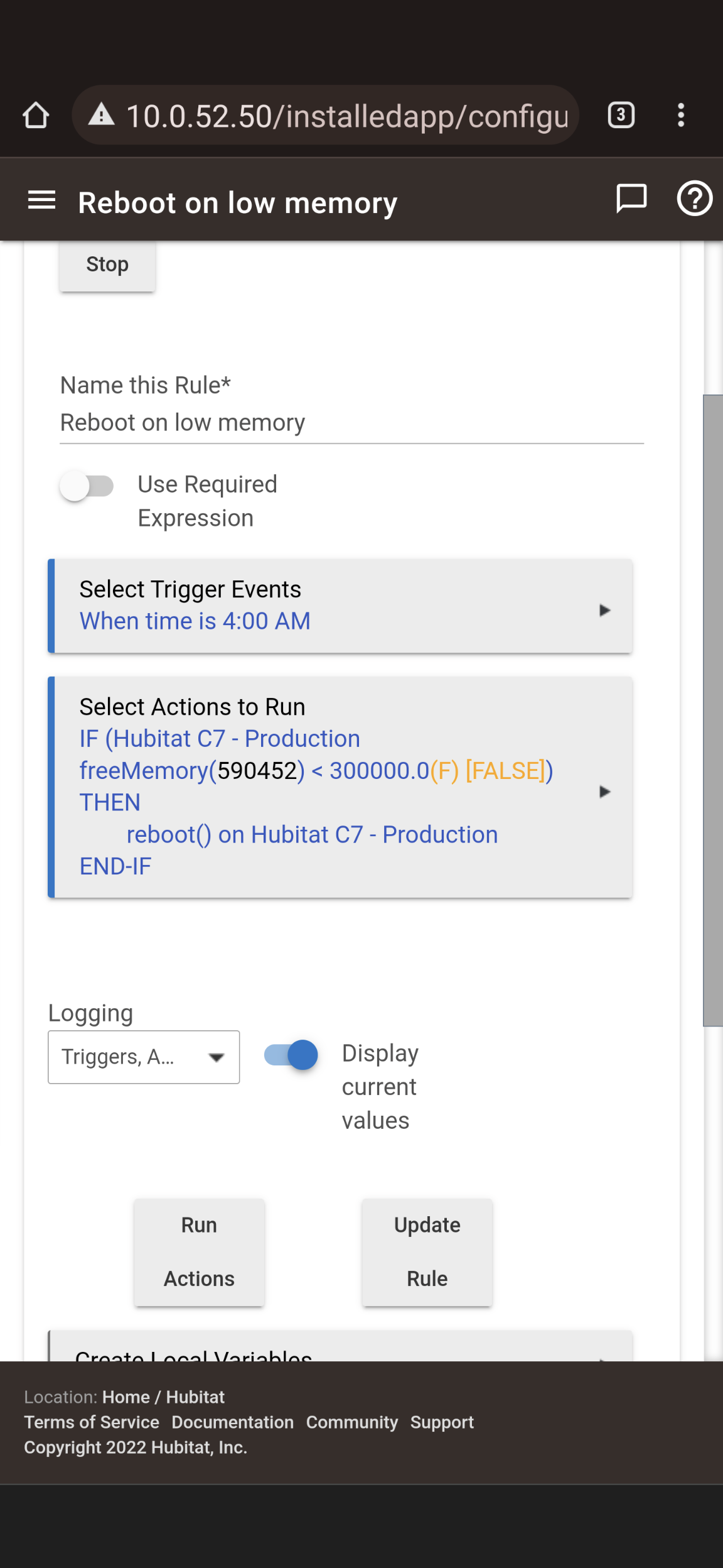

I just check once a day at 4 am. You could change it to whatever frequency you wanted with a rule like this though so memory changes aren't your trigger spamming the hub.
I find my main C7 is stable for about 3-4 days before the memory drops below 300k. The automation rule only runs between midnight and 5am so it doesn’t impact performance on it own.
I get your restrictions in place. I just don't want so many triggers during a window. A time based trigger covers this for me.

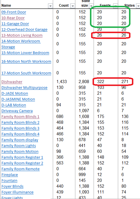

Where do I even change that? I went back and looked at the device/app states events, copied them to a spreadsheet and that is when it got interesting. Unless I'm 100% missing something, it doesn't appear to be observing the max state/event numbers.
The entire hub had a global 20/20 set for them. Some devices (like my nest doorbell), I dropped to 1 since I don't need to bloat the DB with images. When I look at all the devices, some clip properly, others like the dishwasher running indicator that I'm working on lists 322 events, 271 states and counting. That device has 16 listed states.
I checked on for the alarm panel inputs I linked in, some are clipped at 20 / 20, my living room is at 26 / 26. In those cases, each only has 1 state.
My gutt feeling is if you changed the max limit, and the device was already above the max, it doesn't clip and cleanup. If the device was below those limits, then the hub maintains them as expected.

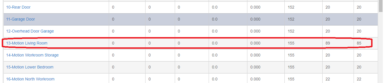

Thanks, let me look at that. It seems to be an issue where the limits aren't being respected on some devices. I clicked the global "apply 20 / 20 to all devices" from the log section. Checked one of my devices, it was still stuck at 5 / 5. The "13-motion living room" from my image above was stuck at 10 / 10 (didn't accept the 20 / 20), but after a reboot, it just continuously climbed. Right now it's at 238 events / states and climbing (those are particularly spamming triggers, so I wanted them clipped low)

I then rebooted, and immediately checked the device in question. It had been clipped to 20 / 20. After a couple of triggers, it climbed past the limits again.
What looks to happen is we reboot, everything gets cleaned up as we expect, and then they start to grow past where they should have stopped. That's why RAM is "disappearing" daily after a reboot. It's not a memory leak, the event / state cleanup isn't working.
