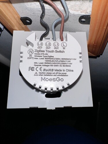

This is the switch I have:
The data panel shows:
  • endpointId: 01
  • application: 42
  • isMultiEP: false
  • manufacturer: _TZE200_g1ib5ldv
  • model: TS0601
The driver I am using with it is Martin Kura's driver, which works fine with the switch but doesn't detect the physical actions.
I've tried Kkossev's driver but sadly it doesn't work with this switch.
Can anybody reccommend a way round this? Or a good 2-gang equivalent of this which works with Hubitat?

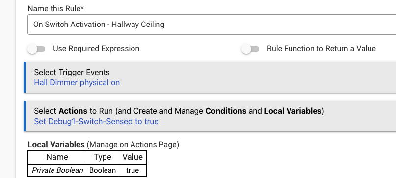

A rule using physical on doesn't do anything:

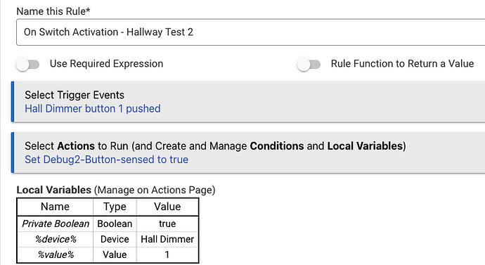

But a rule using button 1 pushed works fine:

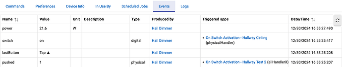

Looking at the Device Logs:
The switch shows as digital, not physical (but it does trigger physicalHandler).
