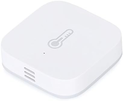

Why not a humidity sensor like this one? This way you can have the fan stay on for as long as it takes to bring the humidity down to normal levels.
Because we don't support these devices as they aren't Zigbee ZHA 1.2 compliant...
@mike.maxwell - looks like I need to bookmark the "supported devices" page! I'm a recent WINK defector and just got my HE yesterday.
Allow me to replace the Xiaomi with the below conversation....
