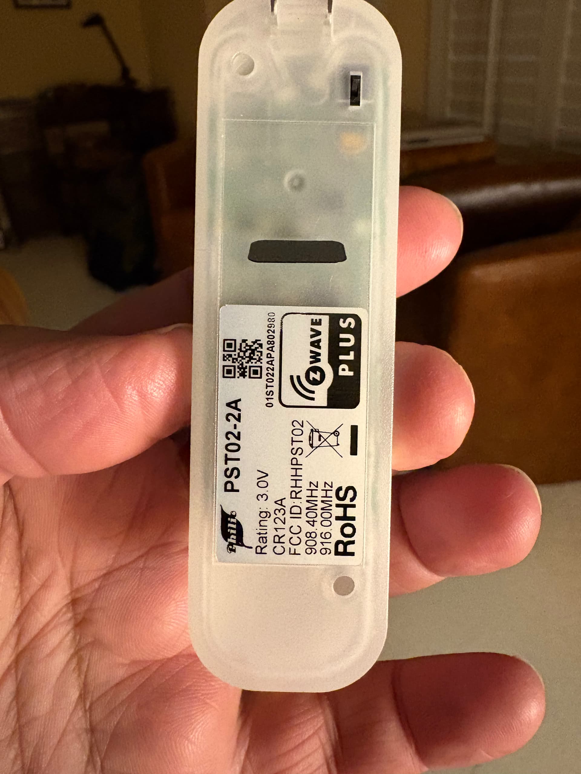

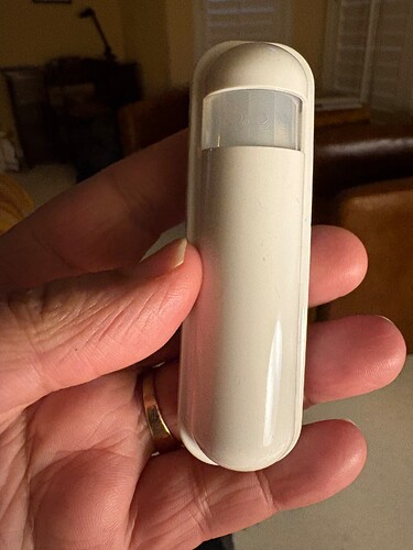

I just got 2 of these and I'm baffled by where the "tamper" keys are. I found the manual but all it says is there is one in the back and one in front and I can't figure out where they are!
Can someone point out what I'm supposed to press to start the inclusion process? Thanks for your help.
UPDATE: I figured out where the tamper key is - it's the little plastic string like thing on the right side top :man_facepalming:t2:.
