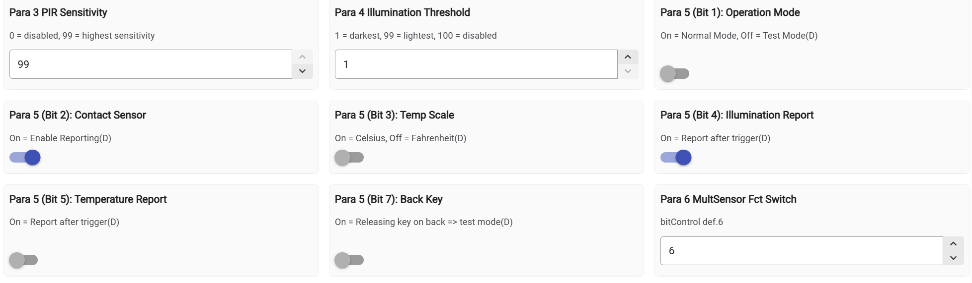

I took the excellent Philio PST02ABC driver developed by @dennypage and extended by @kunpet, as described in this thread, and used cursor.com to extend it to provide control of 2 additional parameters:
  • Parameter 3: PIR sensitivity, Range 0-99, default 80. 0 = disabled, 99 = highest sensitivity.
  • Parameter 22: Illumination differential report. Range 0-99, default 0. 0 = disable, 99 = every 99 minutes. The default setting of this parameter was 0, resulting in no illuminance reporting.

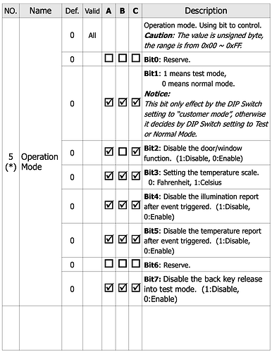

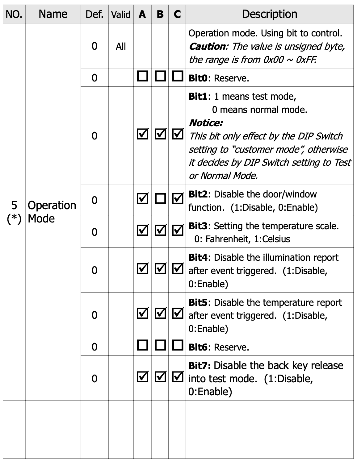

Updated 12/5/2025, V100.4, added control for parameter 4: Illumination threshold. 1 = darkest, 99 = lightest, 100 = disable
Update 12/5/2025 V100.5, Previously, parameter 5 was entered as a decimal number representing a bit mask. To make this easier for the user, I have changed this to a set of 6 toggles. Each toggle explains what it controls so the user can select what they want. The appropriate value for parameter 5 is then calculated automatically. The calculated value can be seen in the state variables on the "commands" page and in the logs. Screenshot of the toggles:
Update 12/21/2025, V100.6, Various bug fixes and improved text in preferences.
The code is below -- posting it in case it is useful for anyone else.
Marc

preferences
    // Device values not configurable by this driver but logged when configure: Parameter 4, 9, 12
    // !! button "configure" sets Defaults specified under deviceSync() - preferenence values are set after "set preference"
    // Parameter 3: PIR sensitivity, Range 0-99, default 80. 0 = disabled, 99 = highest sensitivity.
    input name: "pirSensitivity", title: "Para 3 PIR Sensitivity", description: "0 = disabled, 99 = highest sensitivity", type: "number", defaultValue: "80", range: "0..99"
    // Parameter 4: Illumination threshold. 1 = darkest, 99 = lightest, 100 = disable
    input name: "illuminationThreshold", title: "Para 4 Illumination Threshold", description: "1 = darkest, 99 = lightest, 100 = disabled. Only used if para5, bit4 is turned on.", type: "number", defaultValue: "99", range: "1..100"
    // Parameter 5 broken out into bitmask toggles
    // Bits 0 and 6 are reserved (0)
    // bit 1: On = Normal mode; Off = Test mode. Default this to off (false).
    input name: "p5_normalMode", type: "bool", title: "Para 5 (Bit 1): Operation Mode", description: "On = Normal Mode, Off = Test Mode(D)", defaultValue: false
    // bit 2: On = Enable contact sensor reporting. Default this to on (true).
    input name: "p5_contactReport", type: "bool", title: "Para 5 (Bit 2): Door/Contact Sensor", description: "On = Enable Reporting(D)", defaultValue: true
    // bit 3: On = report temperature in Celsius. Default this to Off (False).
    input name: "p5_celsius", type: "bool", title: "Para 5 (Bit 3): Temp Scale", description: "On = Celsius, Off = Fahrenheit(D)", defaultValue: false
    // Bit 4: On = report illumination after trigger. Default this to on (true).
    input name: "p5_illumReport", type: "bool", title: "Para 5 (Bit 4): Illumination Report", description: "On = Report after trigger(D). If turned on, you can set the threshold via Para4.", defaultValue: true
    // Bit 5: On = report temperature after trigger. Default this to on (true).
    input name: "p5_tempReport", type: "bool", title: "Para 5 (Bit 5): Temperature Report", description: "On = Report after trigger(D)", defaultValue: true
    // Bit 7: On = Enable the back key release into test mode. Default this to on (true).
    input name: "p5_backKey", type: "bool", title: "Para 5 (Bit 7): Back Key", description: "On = Releasing key on back => test mode(D)", defaultValue: true

    // Para 5 - Operation Mode (Calculated from bitmask preferences)
    // Logic: If toggle is ON, bit is 0. If toggle is OFF, bit is 1.
    // Bits 0 and 6 are always 0.
    def b1 = p5_normalMode != null ? p5_normalMode : false // Default Off
    def b2 = p5_contactReport != null ? p5_contactReport : true // Default On
    def b3 = p5_celsius != null ? p5_celsius : true // Default On
    def b4 = p5_illumReport != null ? p5_illumReport : true // Default On
    def b5 = p5_tempReport != null ? p5_tempReport : true // Default On
    def b7 = p5_backKey != null ? p5_backKey : true // Default On
    Integer p5Val = 0
    if (!b1) p5Val += 2     // Bit 1 (2^1)
    if (!b2) p5Val += 4     // Bit 2 (2^2)
    if (!b3) p5Val += 8     // Bit 3 (2^3)
    if (!b4) p5Val += 16    // Bit 4 (2^4)
    if (!b5) p5Val += 32    // Bit 5 (2^5)
    if (!b7) p5Val += 128   // Bit 7 (2^7)
    // Bit 0 and 6 are fixed at 0, so no addition needed.
    value = p5Val
    // Fix for signed byte issue.
    // To set values > 127 in a 1-byte signed field, we must subtract 256.
    def sendValue = value
    if (sendValue > 127) sendValue -= 256
    if (resync || state.para5 != value)
        log.warn "Updating device para5 (Operation Mode): ${value} (Calculated)"
        cmds.add(zwaveSecureEncap(zwave.configurationV1.configurationSet(scaledConfigurationValue: sendValue, parameterNumber: 5, size: 1)))
        cmds.add(zwaveSecureEncap(zwave.configurationV1.configurationGet(parameterNumber: 5)))

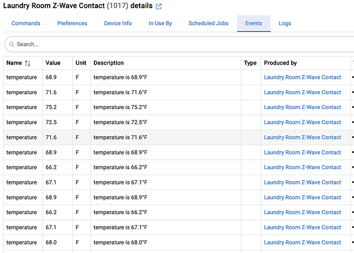

@marcaronson408 - thanks so much for the modified driver. Quick question - I don't see a parameter for Illuminance Threshold? Is there another way to turn off illuminance reporting? I only need the contact sensor capability and I was hoping I could turn the others off.
Thanks for your help.

Parameter 5: Operation Mode
Operation mode. Using bit to control.Caution: The value is unsigned byte, the range is from 0x00 ~ 0xFF.Bit0: Reserve.Bit1: 1 means test mode, 0 means normal mode.Bit2: Disable the door/window function.(1:Disable, 0:Enable)Bit3: Setting the temperature scale.0: Fahrenheit, 1:CelsiusBit4: Disable the illumination report after event triggered.(1:Disable, 0:Enable)Bit5: Disable the temperature report after event triggered.(1:Disable, 0:Enable)Bit6: Reserve.Bit7: Disable the back key release into test mode.(1:Disable, 0:Enable)
Size: 1 Byte, Default Value: 0
Setting Description
0 - 127 Setting Operation mode.
2 Bit1: 1 means test mode, 0 means normal mode.
4 Bit2: Disable the door/windowfunction.(1:Disable, 0:Enable)
8 Bit3: Setting the temperature scale. 0: Fahrenheit, 1:Celsius
10 Bit4: Disable the illumination report after event triggered.(1:Disable, 0:Enable)
20 Bit5: Disable the temperature report after event triggered.(1:Disable, 0:Enable)
40 Bit6: Reserve.
80 Bit7: Disable the back key release into test mode. (1:Disable, 0:Enable)
1 Bit0: Reserve.

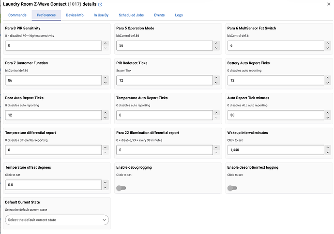

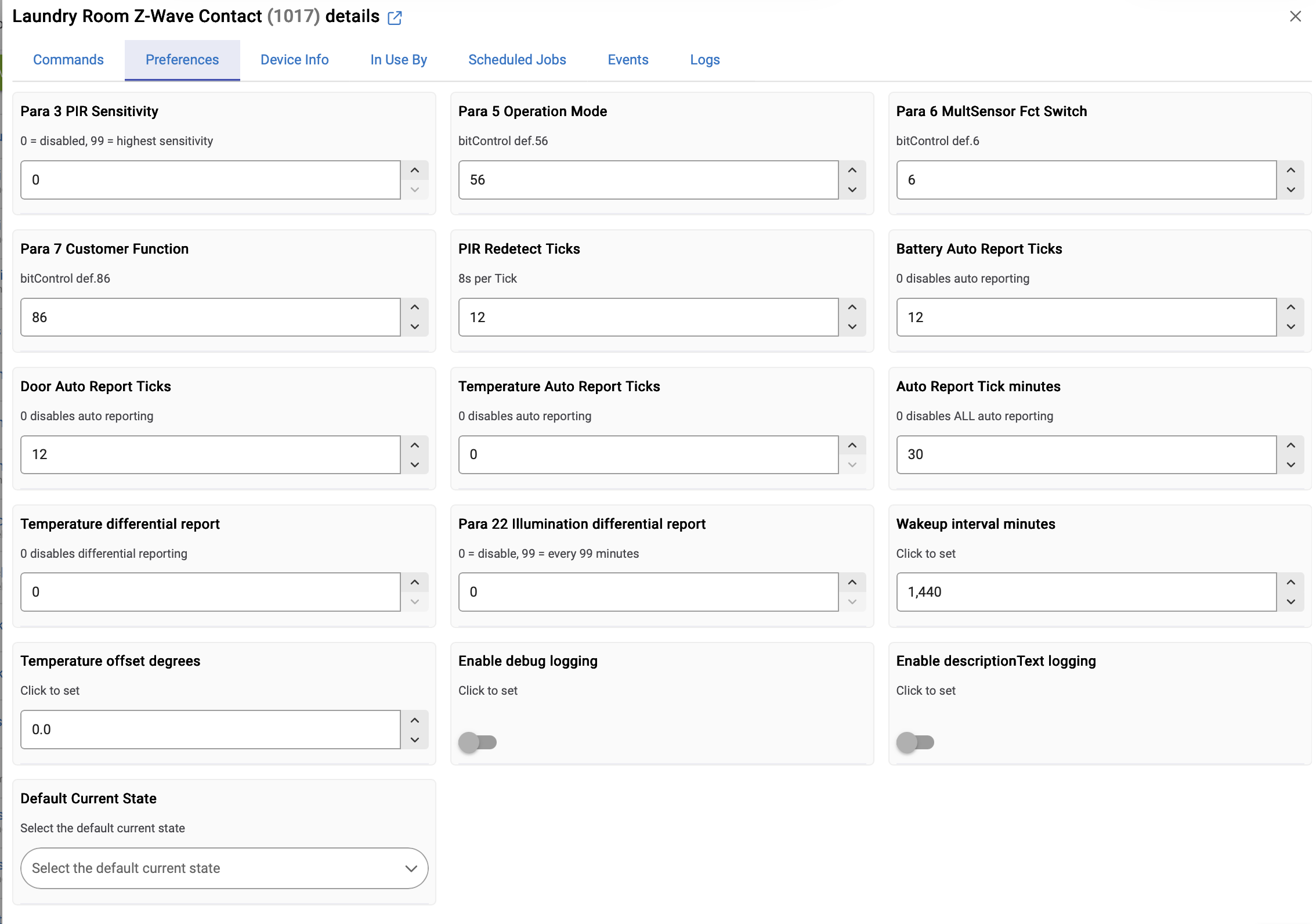

Marc - I have Parameter 22 turned off but not sure how to do the next part. Attached are my current settings. Does the value of "56" need to be changed? If so, can you tell me what to change it to? Thanks!
56 decimal = 111000 in binary. So you have bits 0,1 & 2 set to 0; 3, 4 & 5 set to 1, which means that you have already disabled "illumination report after event".
You also seem to have temperature reporting set to Celsius, not Fahrenheit. Are you seeing temperatures being reported in Celsius?
Marc

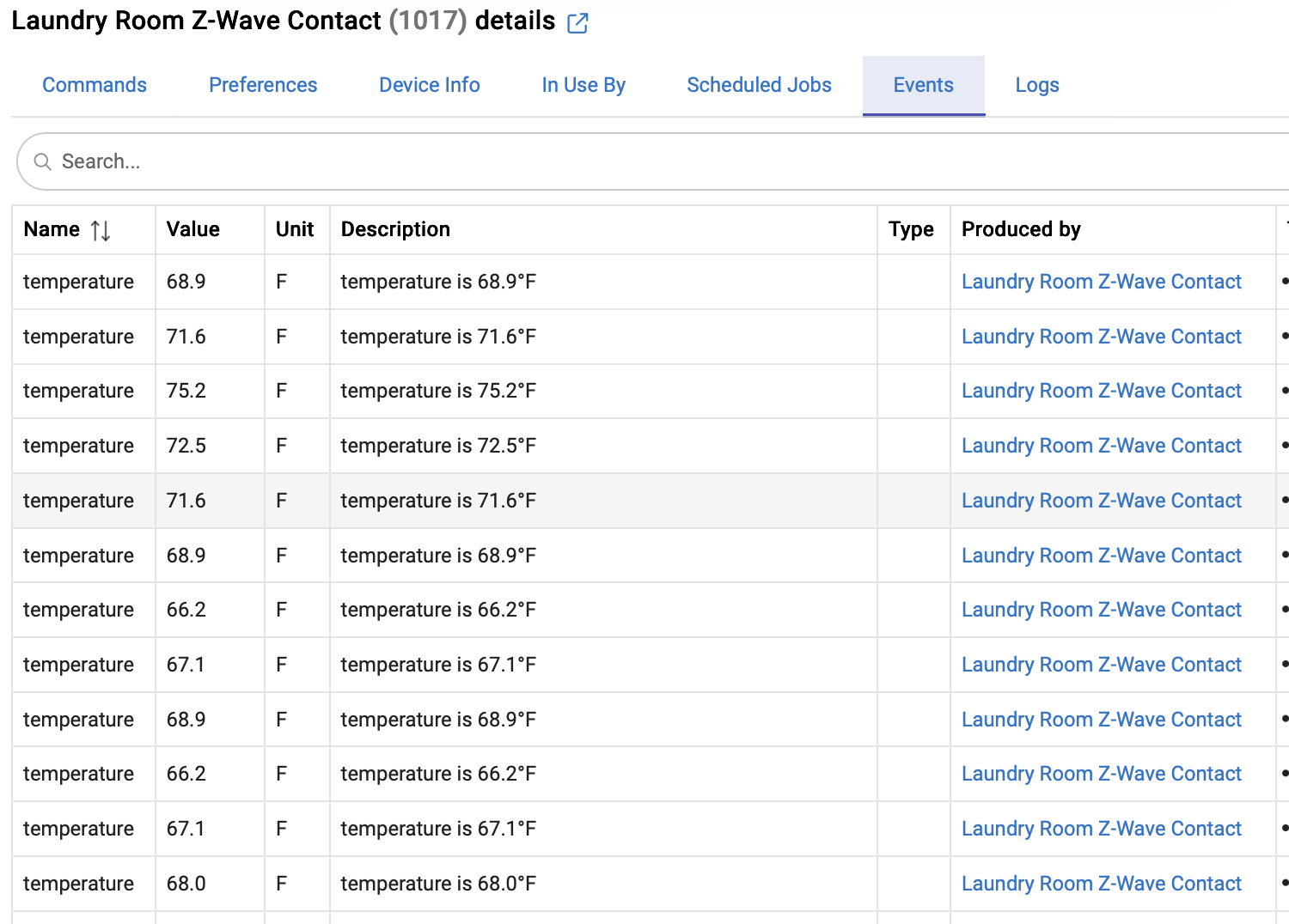

In Event logs, the value is shown in fahrenheit. I think the only settings I changed were the ones relating to disable PIR reporting and temperature reporting intervals.
OK, let's try a simple experiment to see if I am mis-reading which value in bit 4 disables this function.
Try changing parameter 5 from 56 to 40, as this will change bit4 from 1 to 0.
Keep in mind that the device needs to wake up before it actually gets reconfigured. On mine, I had to remove the front cover and push the little button in the upper-left corner of the device -- circled in red in the photo below. You can confirm that the device got updated by looking on the device's "Commands" tab and seeing what value is showing for "Para 5".
If this doesn't solve it, we're going to have to use the basic z-wave driver to update parameter 4.
Marc
@marcaronson408 - we are leaving to go out of the country in the next few hours. Will be back in about 10 days and will give this a try.
Also, in looking at the manual, bit 4 (of Parameter 5) if for the illumination report? Or am I misunderstanding what is there?
Yes, bit 4 is for the illumination report. The ambiguous part is the way it is worded: " Bit4: Disable the illumination report after event triggered.(1:Disable, 0:Enable)".
It probably means a value of 1 disables illumination reporting, and that is your current setting.
But there is another way of interpreting that statement that inverts the meaning, which is why I suggest trying the other value I provided earlier, as that will set bit4 to 0.
Or have I misunderstood what you are trying to accomplish?

I just made another update so that you don't need to translate binary bit maps into decimal to set parameter 5. Instead, there are 6 documented toggles so you can choose what you want turned on and turned off. The driver then automatically calculates the correct value for parameter 5.
"(D)" indicates the default values.

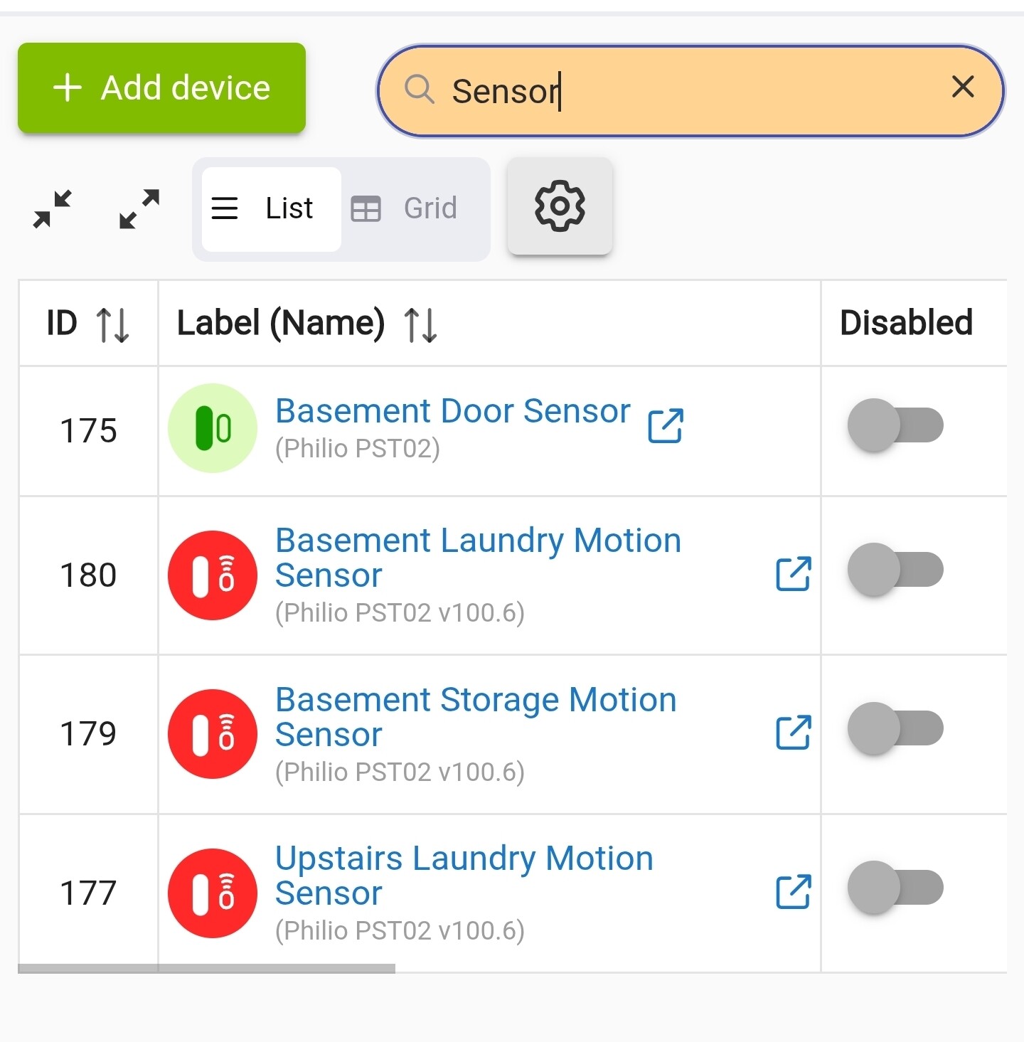

Hello!
Thanks for the driver's as it works well for my PST02-A! I found one of my sensors got stuck and not clearing motion, actually excluding and including worked well for me... In case it helps anyone.
One question I had, is there anyway to change the default icon you see under devices from contact, to motion? My contact is open since I use it for motion, but it reports I have contact open.
Thanks!
Where are you seeing the icon? ie, The device list as viewed in your browser vs. on a dashboard vs. somewhere else?
Marc
Thanks for your reply! See below, Im using 1 as a door and 3 as motion, but the icon shows all as contact (since the other icons match what my contact sensor looks like when open)
I tried a couple of experiments to see if I could change the icon that is displayed for the device, but I did not have any success. in my case it doesn't matter what icon is shown on the device list because I focus on making the icon correct in my dashboards.
This happens because the device is a multisensor. there's no clear documentation that I found that explains how to change the icon that is displayed in the device list for a device that is capable of sensing multiple things.
You could try creating a separate copy of the driver and deleting the capabilities that you don't need. if the only capability the driver exposes is motion sensor, then you might get the icon you're looking for but it might create other problems. you would need to try it to see if it works. this also means that you'll have to maintain two separate copies of the driver so if additional bug fixes are published you'll have to merge them into your copy of the driver.
Marc
