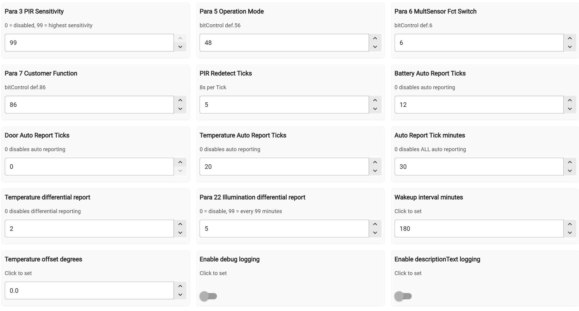

@augustov and @snowman, please see this thread about an updated version of the driver that adds control of parameters 3 (PIR sensitivity) & 22 (illumination control).
Here are the settings I am using, in case they help:
Below is an explanation of what "Customer Function" does. I set mine to 86 decimal; @snowman set his to 94 decimal. The difference is that I have bit 3 turned off.
