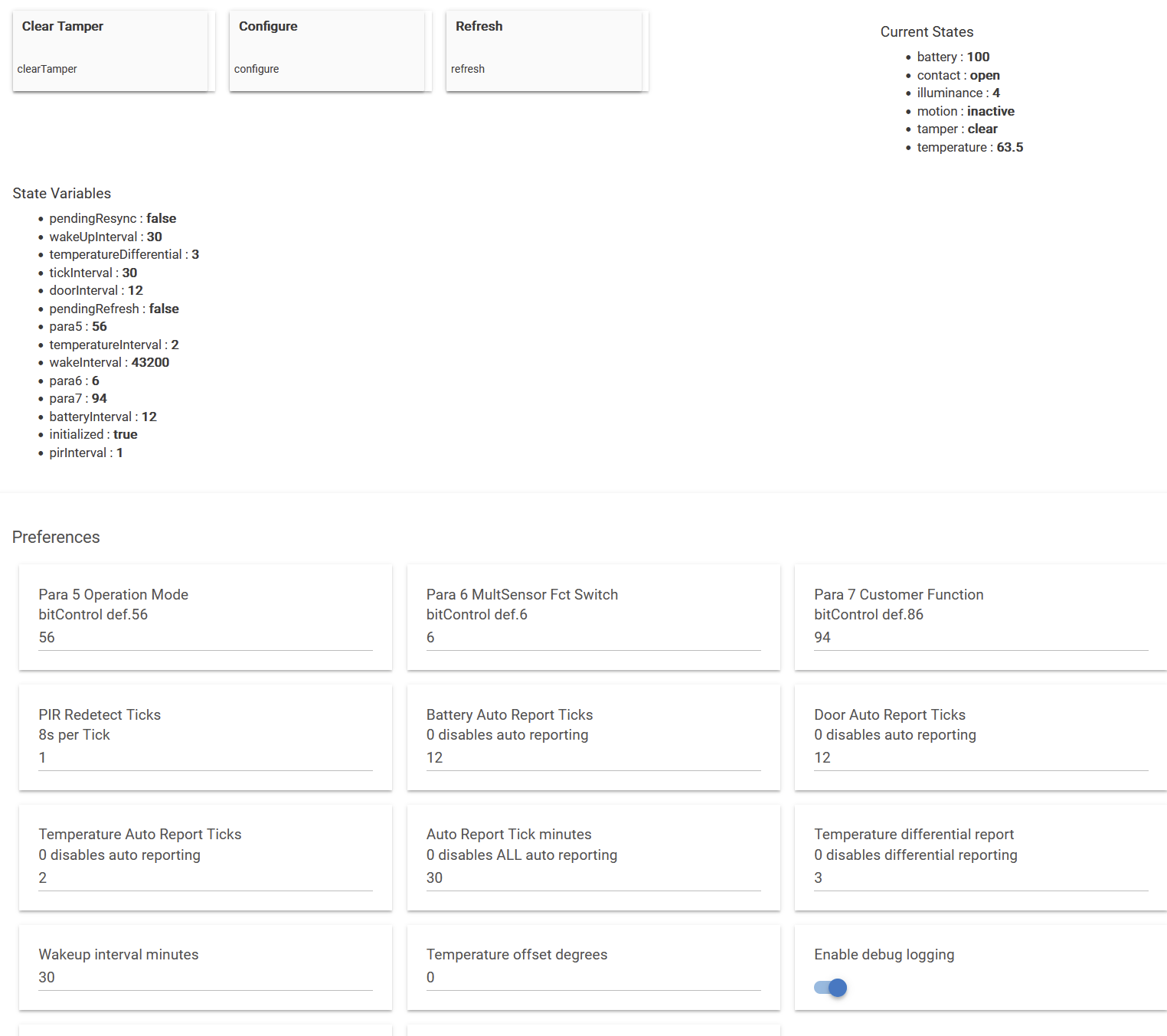

I used this from @kunpet and it worked great save the motion sensor wouldn't give me real-time "active" or "Inactive" readings. After a bit more digging I discovered that "Para 7 Customer Function" in kunpet's git driver needs to be set to 94 - once I did that it worked just fine. Hope this helps.

Not sure - but here's my config:

Here are the settings I am using, in case they help:
Below is an explanation of what "Customer Function" does. I set mine to 86 decimal; @snowman set his to 94 decimal. The difference is that I have bit 3 turned off.
