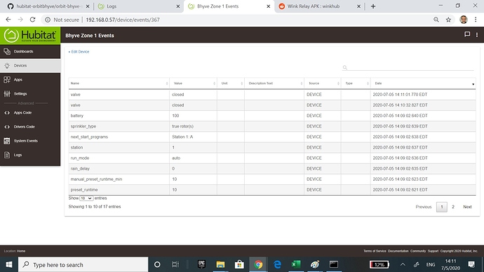

Something I have noticed is that In the events tab, the latest driver installed yesterday, has not communicated any status for the last 10 hours, despite the refresh time in the application was set to 1 minute. I have updated the app to refresh every hour and the device is communicating again providing status in the event page.
The second thing I have noticed is that when I press the OPEN button in the device page, the event shows the close button instead. Could it be that the open button is not correctly mapped? Because Close and open buttons shows the same status in the event page as "CLOSE". See the latest event after 4 times pressing OPEN

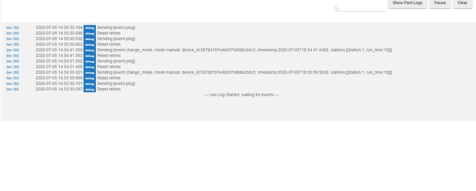

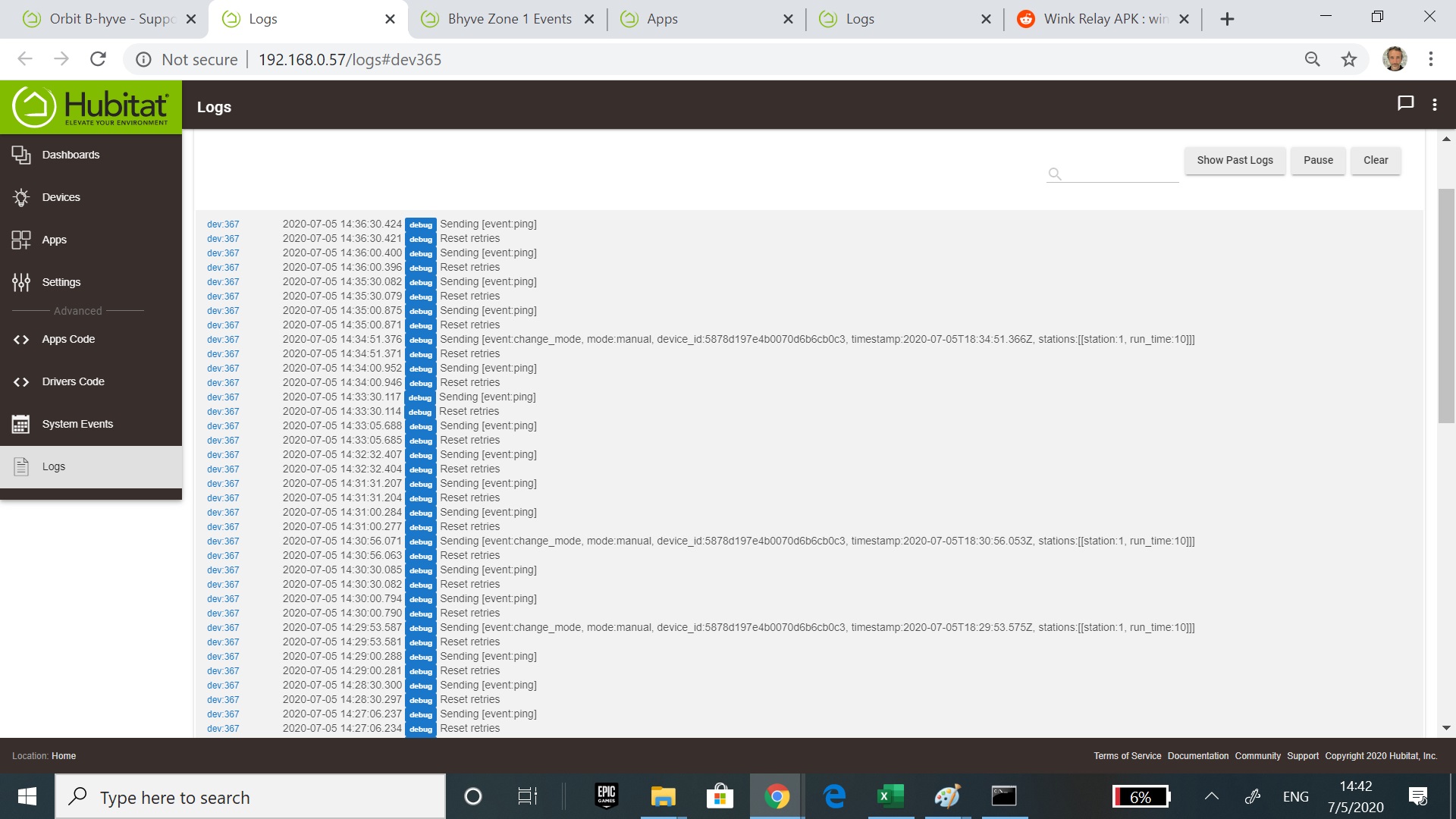

Alright, lots of changes! Please uninstall the app and upgrade the app and the sprinkler timer driver. It's going to probably flood the logs a little bit, I'm trying to log more information so I can find the problem if you still encounter errors.

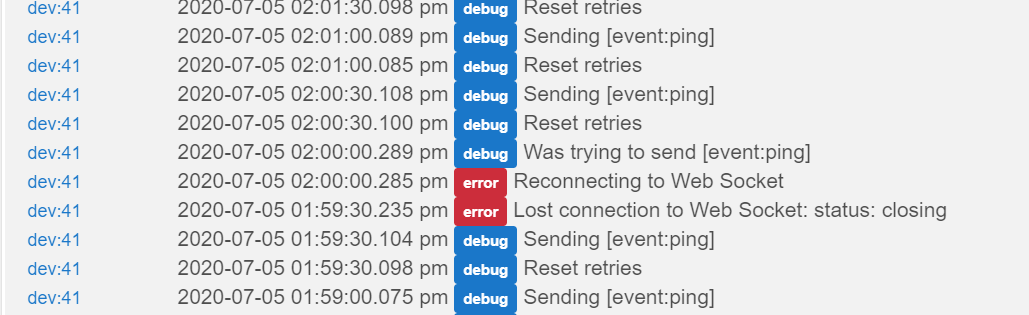

You'll occasionally see something like:
That means it got disconnected but reconnected successfully. If you see lots of reconnects in a row, let me know.
so far this is what i found
Not working. same behavior.... When I press open the event log shows Valve closed

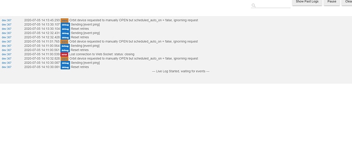

Not sure what this IGNORING REQUEST is
But it's staying connected to the websocket which is good. So I was just chatting with the ST author. Let's give this a try. In the Sprinkler Timer find:
def open() {
if (device.latestValue('scheduled_auto_on')=='true') {
parent.sendRequest('open', device.latestValue('id'), device.latestValue('station'),device.latestValue('preset_runtime') )
} else { def message = "Orbit device requested to manually OPEN but scheduled_auto_on = false, ignorning request"
log.warn message
sendEvent(name: "valve", value: "closed", isStateChange: true, linkText: message)
And change it to just
def open() {
Can you tell me if that works?

Starts on line 77 of orbit-bhyve-sprinkler-timer.groovy
It is working now!!!!!
I have tried twice and it is working.
I had to uninstall the APP and install it again on top of the changes in the driver

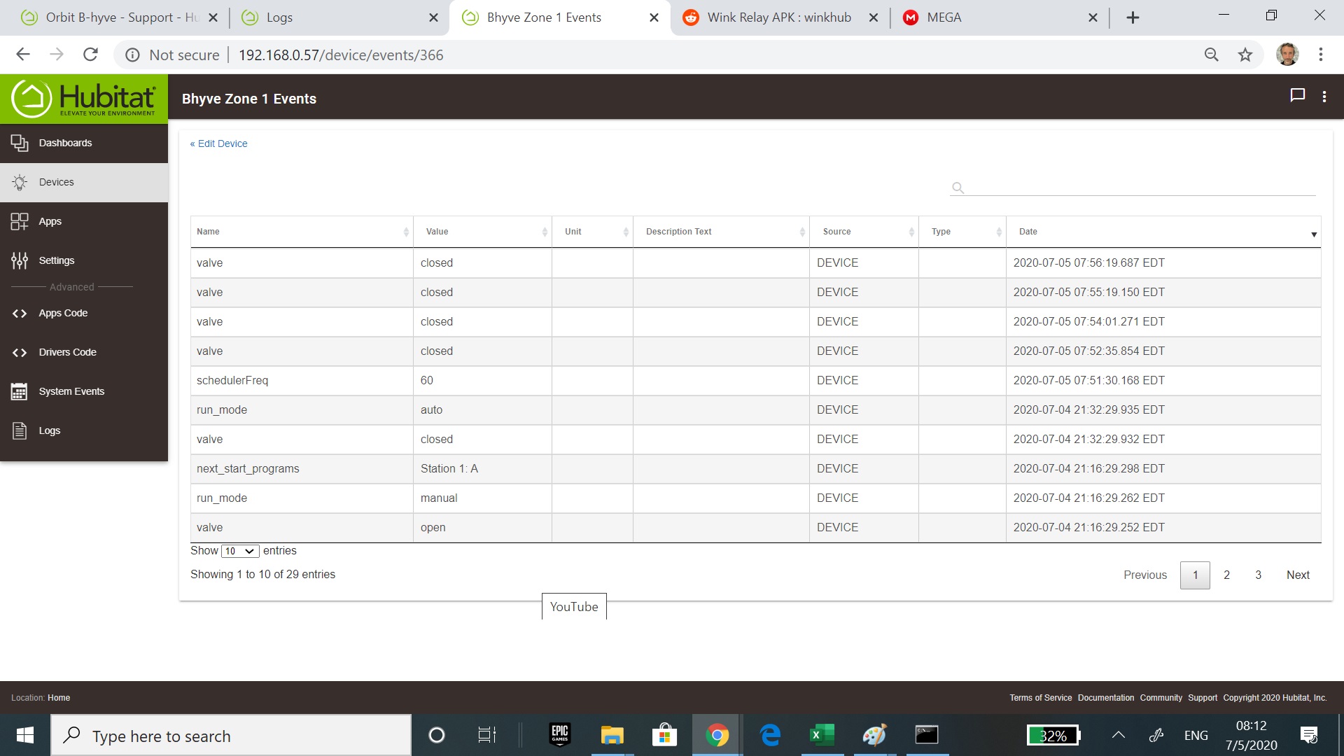

It worked twice but now it is not working again. Seems to be related with a time out or re connection
New findings.... If I reinstall the app.... it is working again... I did not select any notification this time..... and now it is working for the last 10minutes.... The only difference is that I did not select to notify any event ( Open/close/ etc)..... Not sure if this is is related
Update: I have tested the app after 30m and it is working.... I am quite convinced this is related to the notifications
I highly doubt that, the notifications aren't even in the same "program." Notifications are handled by the app and the open/close is handled by the driver. I think it was just a coincidence. Keep an eye on it and let me know if you start seeing errors. Occassional Reconnects seem normal, but if it happens a lot let me know. So far mine has been running for about 5 hours successfully.
