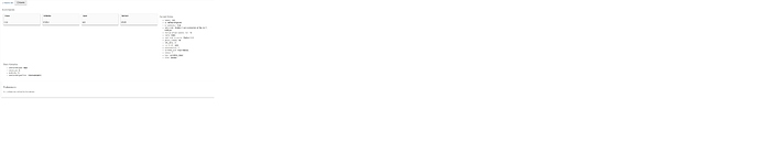

2 errors in 1 hour in my logs..... so this is good I think.... However, it is not working again... Here the logs

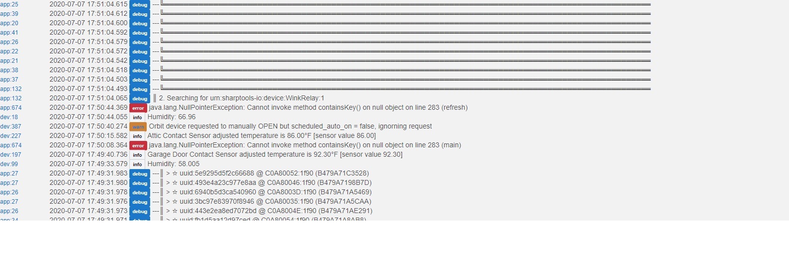

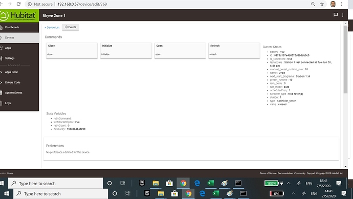

Hello I finally was able to test it... It is not working showing closed in the events section every time I press OPEN...See the events and logs associated

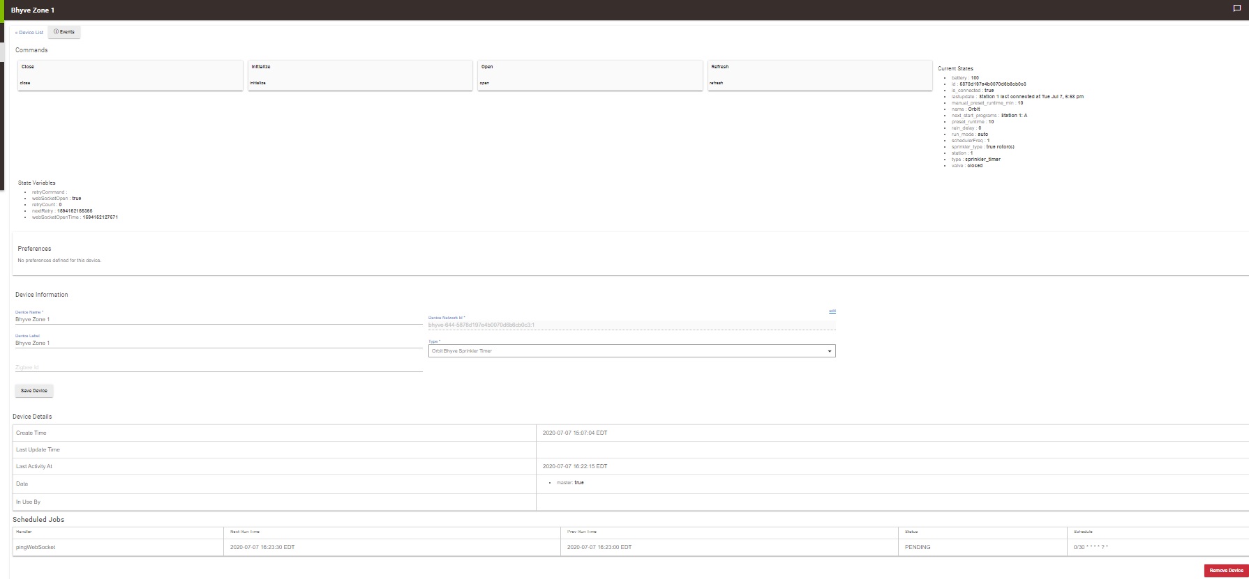

Can you show me the device state? The logs show it is ignoring your commands because scheduled_auto_on is false for some reason.
Yup. Can you show me logs from 15:07 when the device was created? For some reason it didnโt create all the attributes for you
