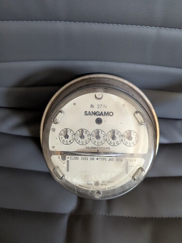

Rather Have the old mechanical meter...LoL

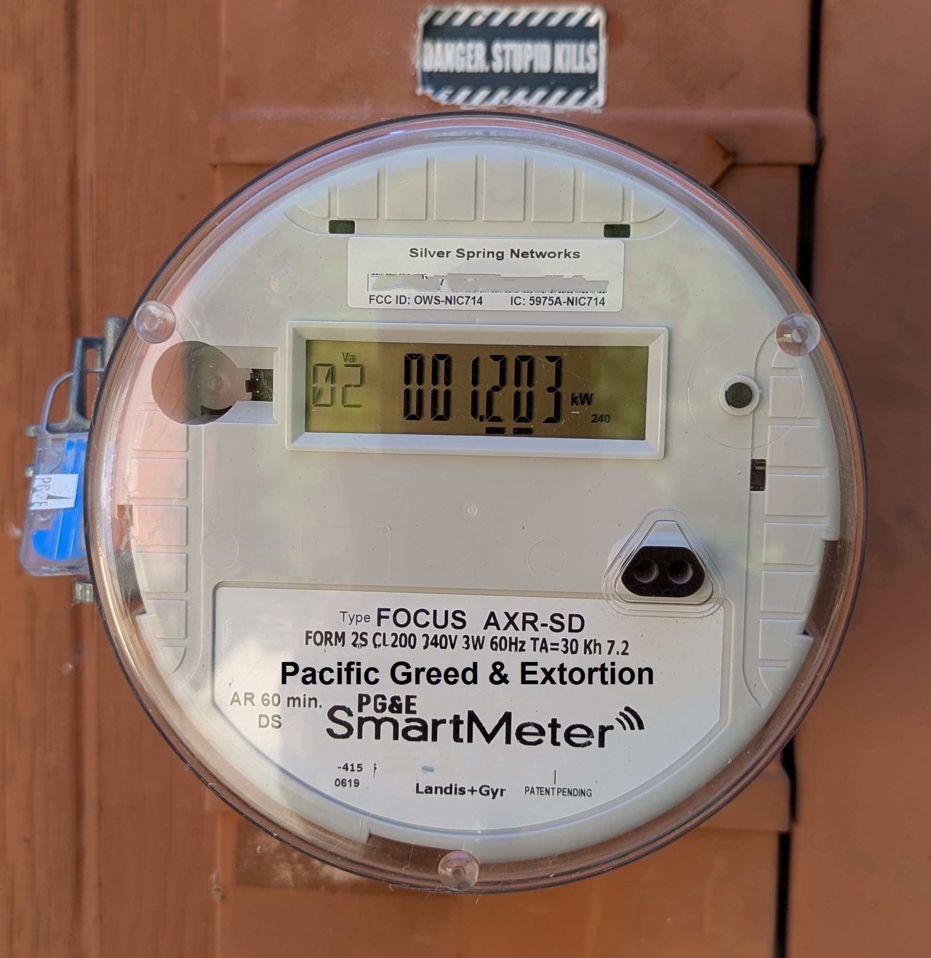

But I get a SmartMeter from PG&E with the highest rates in the nation...

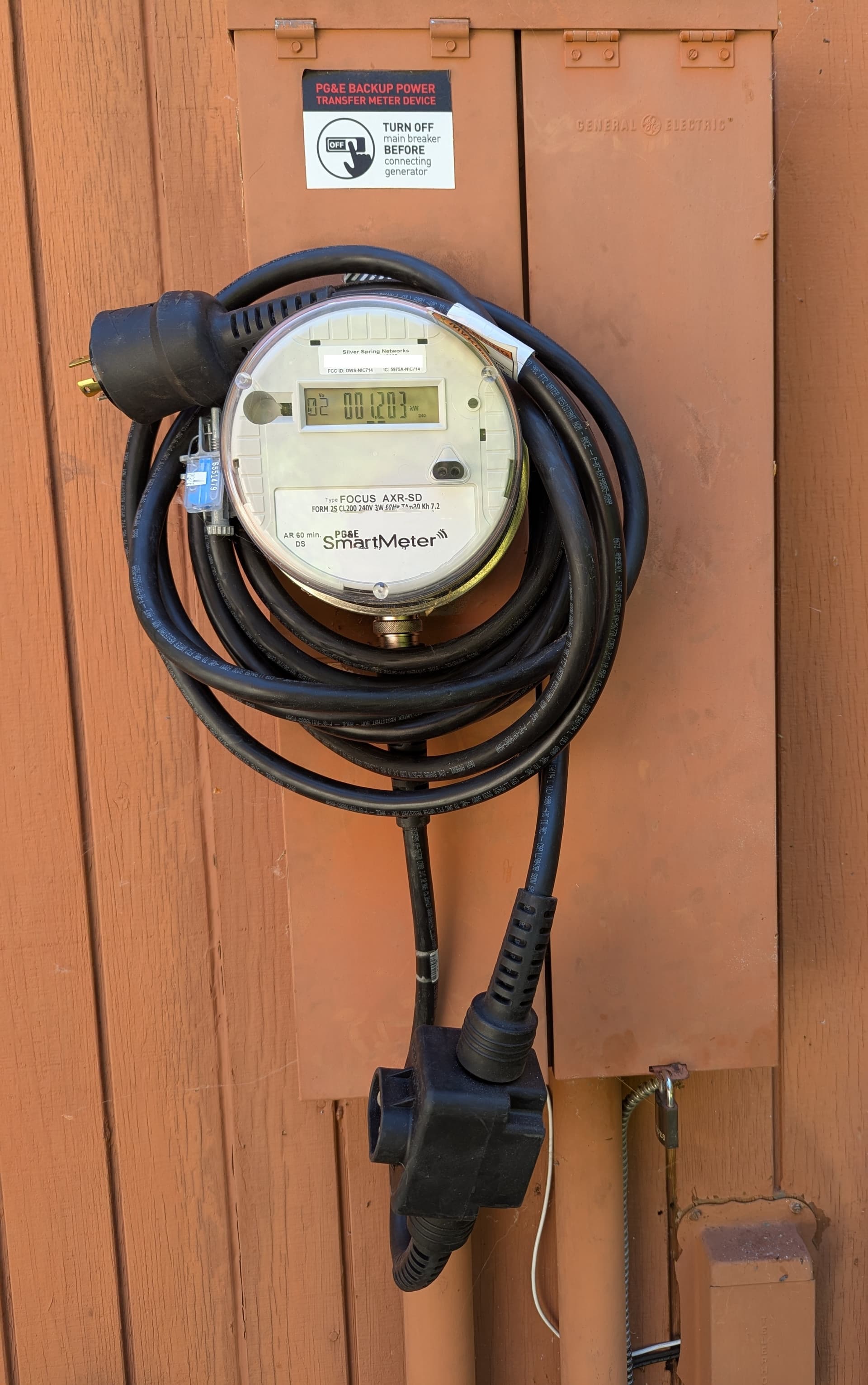

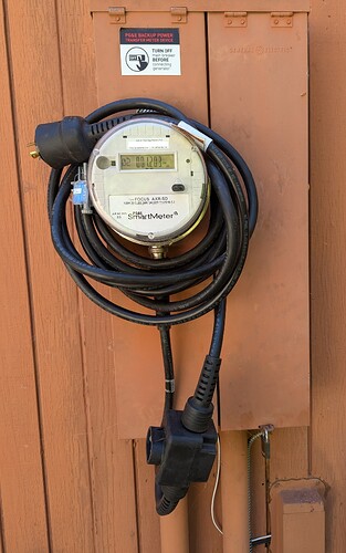

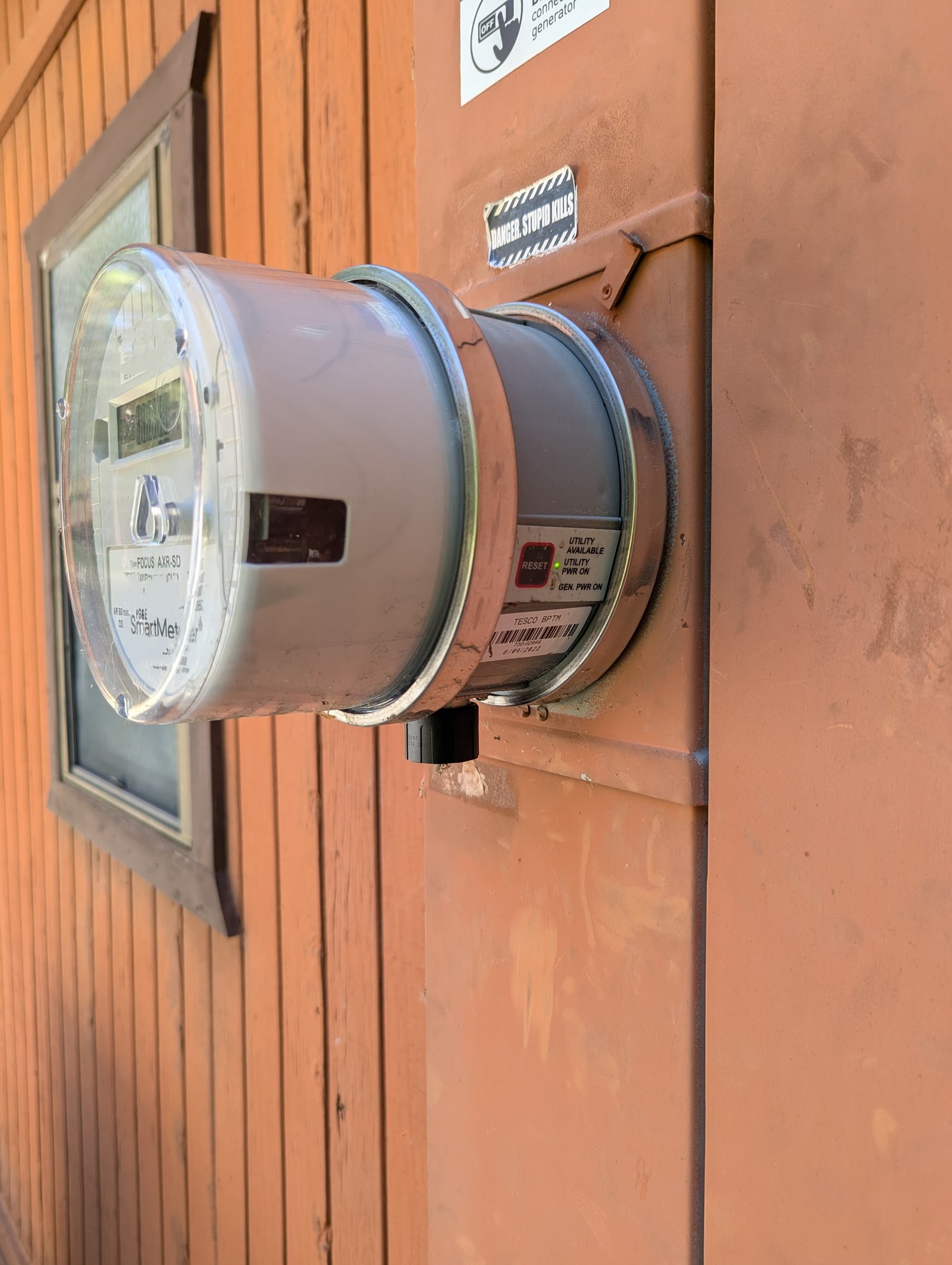

And my power is so Undependable the power company loans you a Power Transfer Switch for your generator.
@Sebastien - I don't get the monitoring feature due to being rural PG&E doesn't offer that, but the meter is read remotely as the SmartMeters run a mesh network and the meters pass their data through each other until they get to a main node to send back to the utility.
