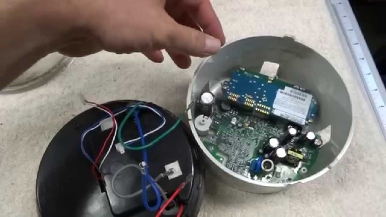

This guy gives a basic explanation of how a smart meter works.
The power company can turn off your power remotely. Get the tin foil hats out.
