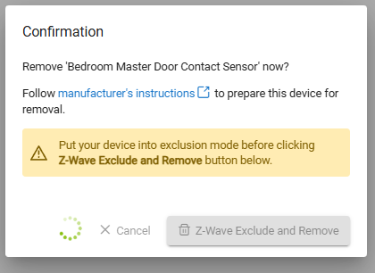

I see a lot of posts regarding removing a "ghost" device that's in the zwave list but not device list, but I have the opposite problem. I have a device but no reference in the zwave list. However I can't remove it. When on the device page and click "remove" and I say yes. It just sits there forever and never finishes the exclude process and I can't remove the device.
Any ideas?
adding more details:

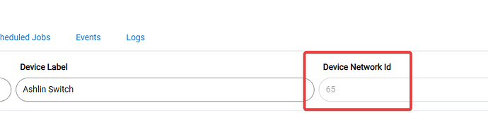

When I get to this screen after I click remove on the device:
I can click z-wave exclude and remove and see this:
And it just stays like this for as long as I leave it.

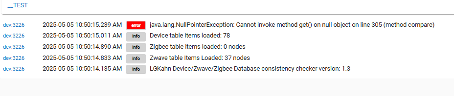

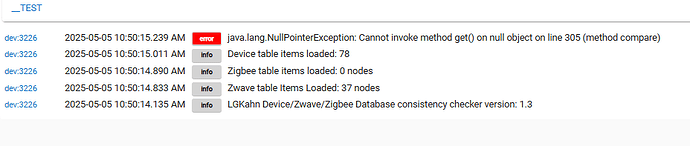

Nice app!
Probably no shock, but output from your app
I had this happen to me as well. I was able to figure out, if you have manyally changed the Network ID for the device to something that isn't a valid z-wave node number, then the removal fails.
I had rebuilt my ZWave network awhile ago, and changed all the Z-Wave device network IDs on old devices to custom ones so they didn't interfere with the Zwave naming schema (node 01 became Z_01, etc) After doing this I reset my radio and then reinstalled all my ZWave devices, swapped devices with the swap device app, and then for whatever reason, I could not delete the old devices. The removal would just hang at the ZWave exclusion part even though the devices weren't part of Zwave anymore.
What I had to do was pick a VALID, but UNUSED Zwave devices node number (in my case I chose to use CC) and once I changed the Network ID to CC, the device could be removed without issue.

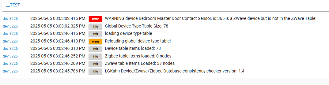

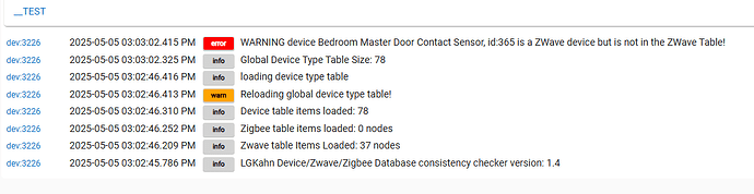

ok made some some change to fix the error. try a github repair or manually refresh the code
Is there a way to fix the corruption?
good may want to schedule it to run in preferences every so often and write a rule to notify you (once you get it fixed)

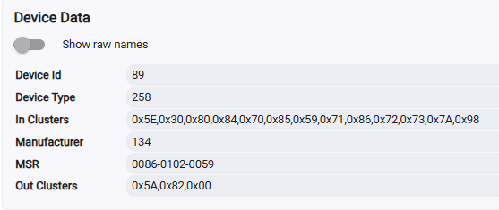

Look at the DNI, it needs to be a two character hex string. If you have edited it at all, it could be something other than that. If you need to change it just look at your z-wave details and pick something not in use, like CC, or FF.
Apparently there is a bug in the latest platform that breaks the force remove if the DNI is totally invalid @gopher.ny
That was it!! Thank you! Changed it to CC and then was able to remove.
