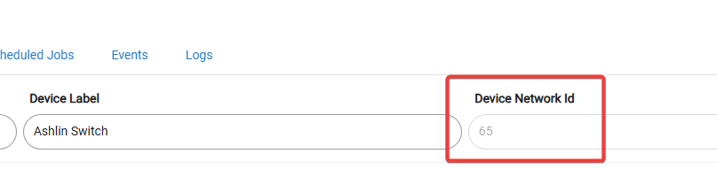

Unable to force remove old Zwave device if the DNI was edited and is not a standard Zwave node ID format. User confirmed after fixing the DNI they could force remove.
Could you explain this a bit more I don't know what valid but "unused" node number.
Look at the DNI, it needs to be a two character hex string. If you have edited it at all, it could be something other than that. If you need to change it just look at your z-wave details and pick something not in use, like CC, or FF.
Apparently there is a bug in the latest platform that breaks the force remove if the DNI is totally invalid @gopher.ny
[image]

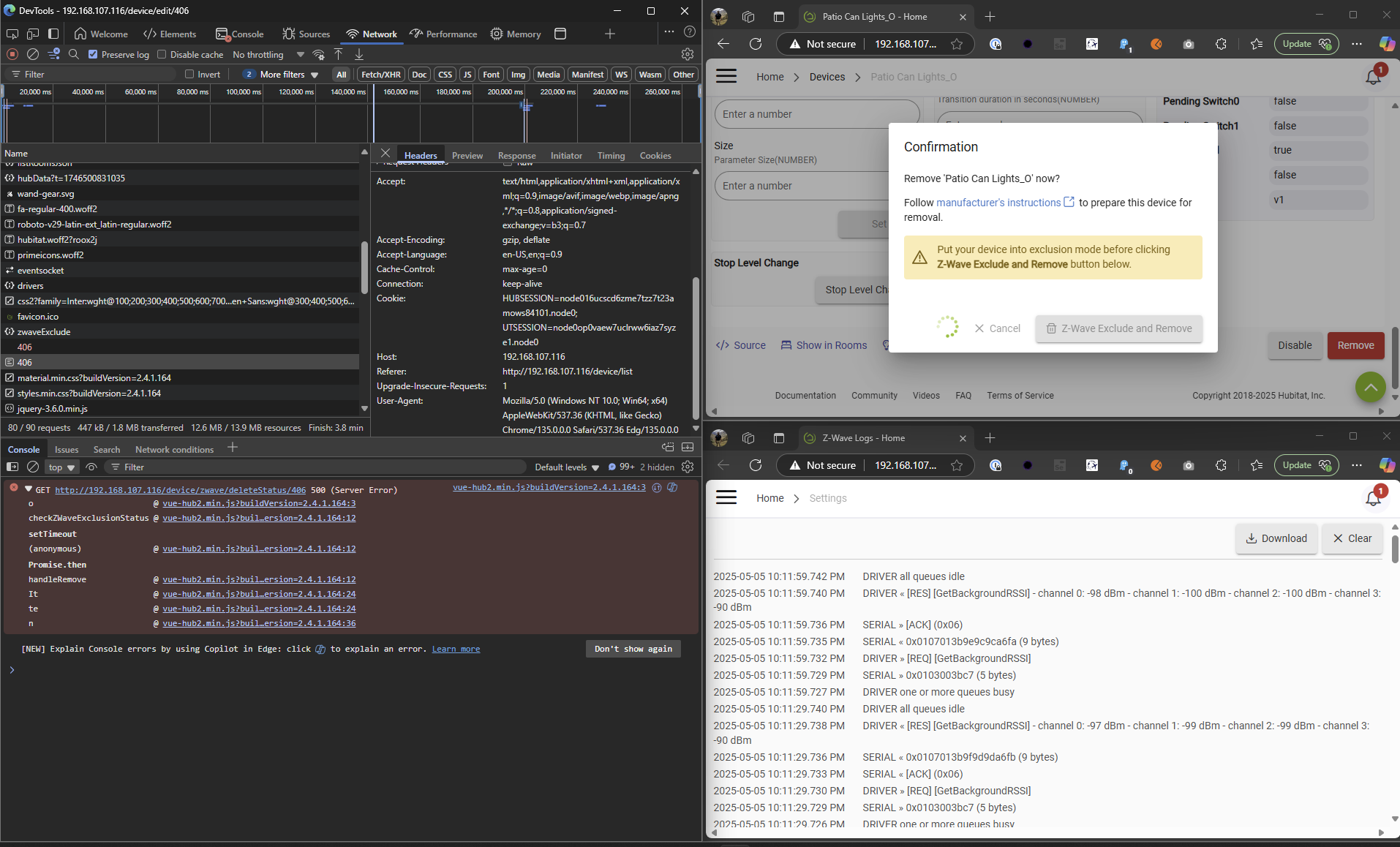

@gopher.ny more details here on what is causing the issue:
I haven't seen that option, so I dug into it, and it seems I get a 500 error when it checks the delete status endpoint (/device/zwave/deleteStatus/406):
[image]
My Hub :
Platform version: 2.4.1.164
Hardware version: C-8 Pro
Diagnostics tool version: 1.1.131
I tried rebooting and looking through the logs for related errors, but I haven't found anything that stands out.
