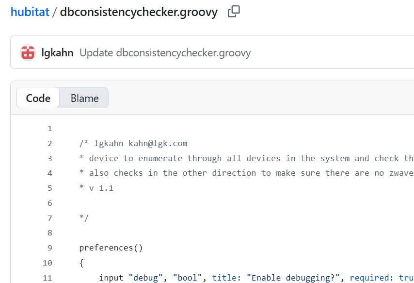

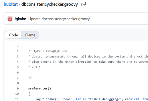

Larry - just noticed, not seeing v1.3 in GitHub, still looks like 1.1...unless it's just a case of version number in the code not getting udpated. :slight_smile:

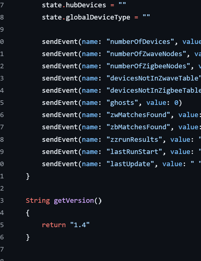

didnt update initial comment.. if look at end of source its actually v 1.4

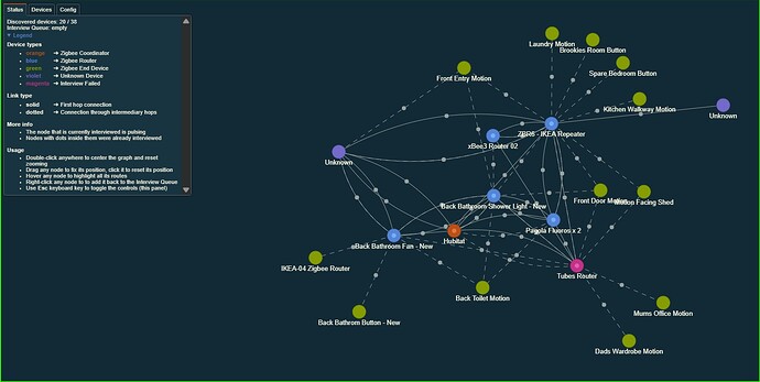

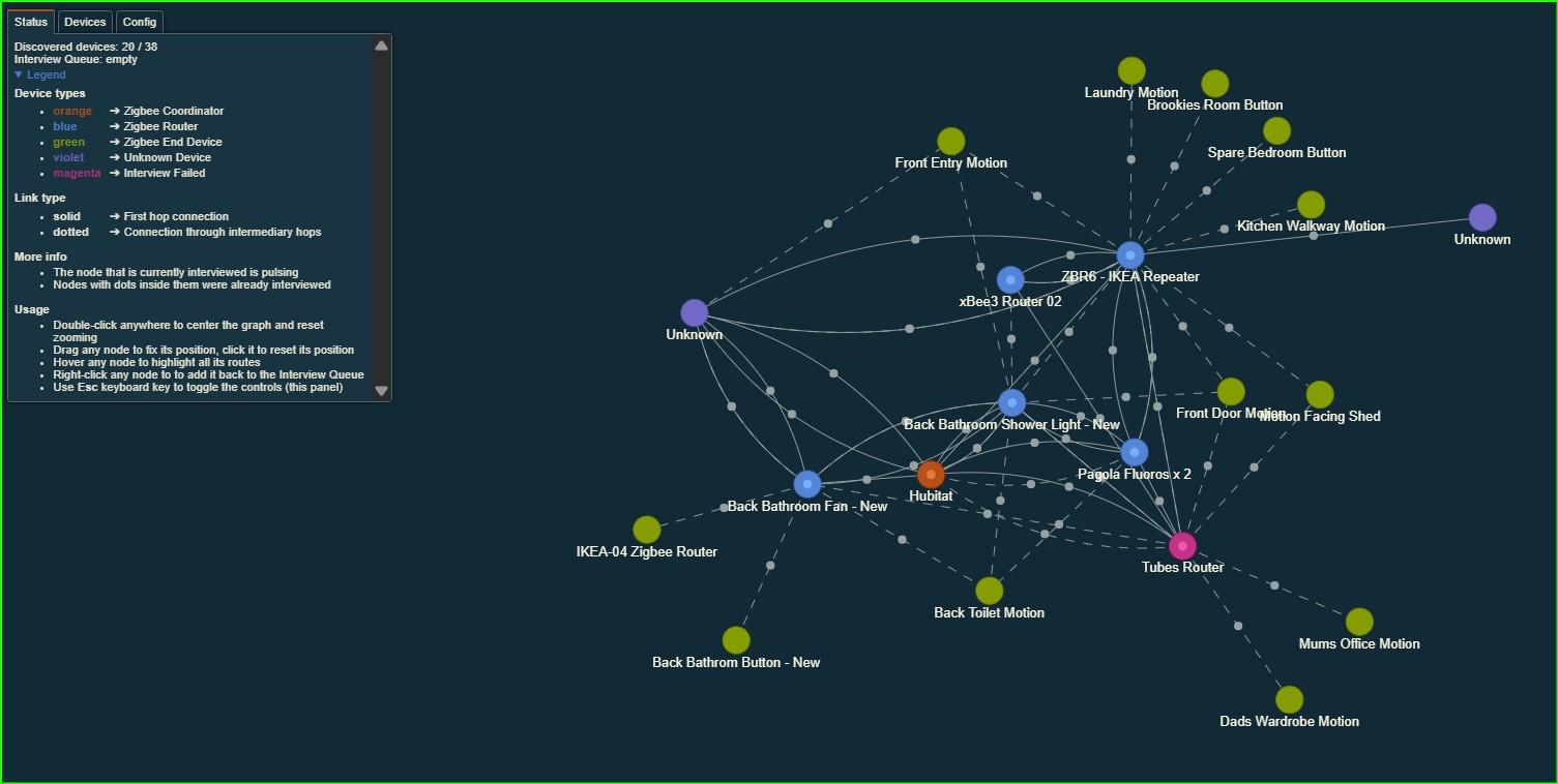

I have 2 Ghosts I cannot identify nor am I able delete from my Zigbee Mesh, please see by the attached pic, is there something I'm missing with the ghost checker?
Cheers
unknown in the zigbee is not a ghost as there are no actual devices in your system for these. they are just probably previously removed devices that the given zigbee device kept in its routing table. this is pretty normal and the only way to get rid of them is to totally reset the zigbee device and pair it again
