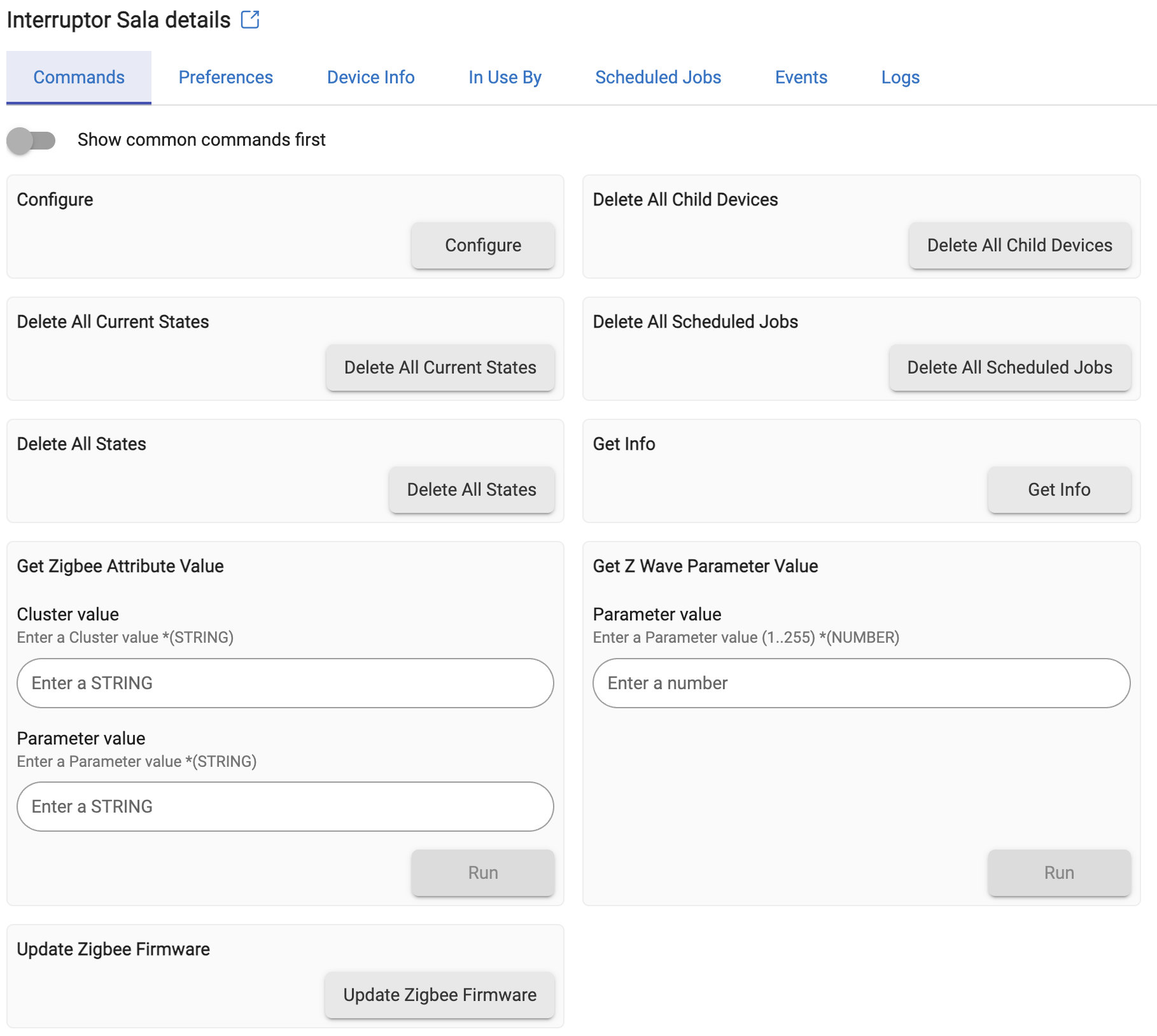

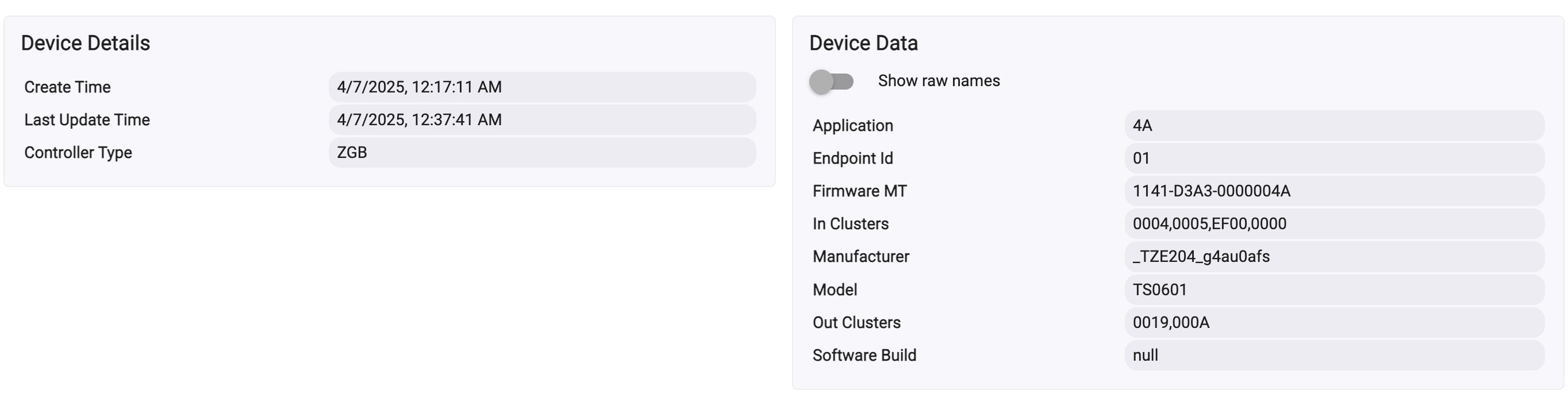

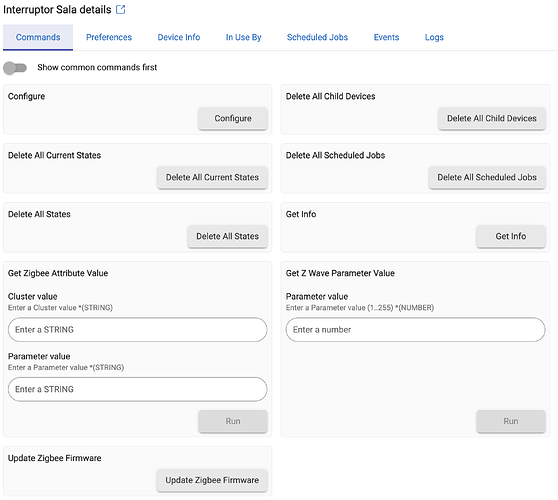

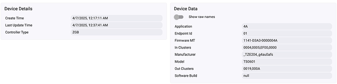

This is the log output from the Hubitat device page (it detects and pairs fine as an unknown Zigbee device) but I cannot control any of the 6 switches from Hubitat and thus can't create any automation (or at least I couldn't find a way. See screenshots).

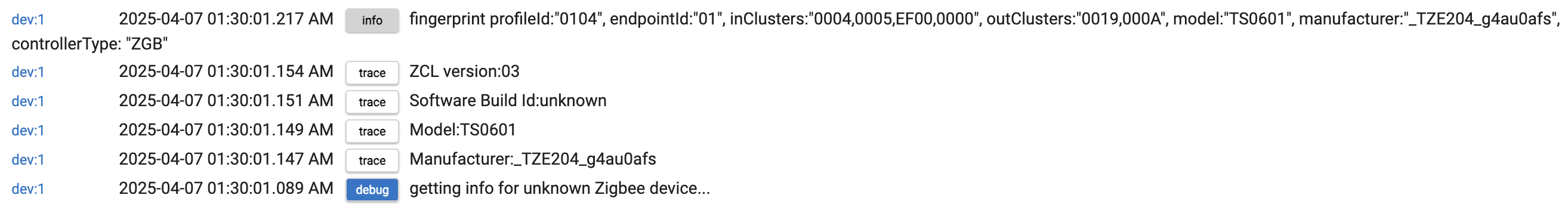

Hitting "Get Info" and checking the logs:
INFO fingerprint profileId:"0104", endpointId:"01", inClusters:"0004,0005,EF00,0000", outClusters:"0019,000A", model:"TS0601", manufacturer:"_TZE204_g4au0afs", controllerType: "ZGB"
TRACE ZCL version:03
TRACE Software Build Id:unknown
TRACE Model:TS0601
TRACE Manufacturer:_TZE204_g4au0afs
DEBUG getting info for unknown Zigbee device...
