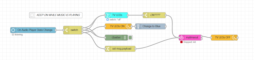

Did I send this to you in PM when i sent the one that i use to turn light on/off when Alexa is talking without a light sensor?
I am sure the experts here can find a more efficient way or make improvements to it. When Alexa is playing music, she sends a message from the On Audio Player State Change that she is "Playing". However, every time she changes songs, she sends a "Stopped" then almost immediately "Playing" again so I have the mytimeout Node set to 5 seconds so that the light doesn't flash at every song transition.
