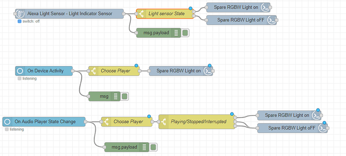

on audio player state change doesn't allow the switch for the device to work.
I have to have an activity node in there to specify

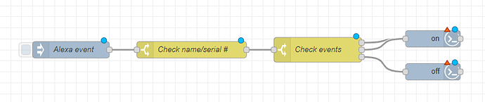

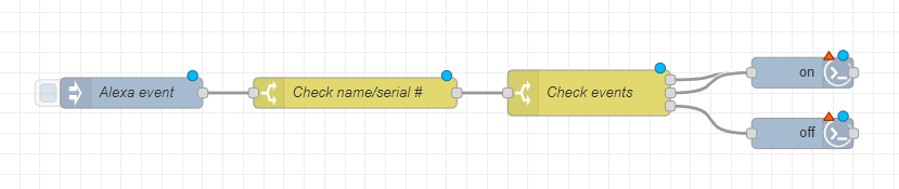

So if the alexa event has a distinguishing value that identifies the device - msg.name, serial #, other, then use two switches in series.
1st one checks if name/serial # is the one you want. If it is a match, then msg flow continues. Then
the second switch block checks activity (basically what you have now).

Somnething like:

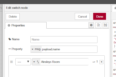

@april.brandt This is what your debug node should output in debug window pane:
So you Switch Node is:
In my case, the Echo Dot is called Ainsleys Room in Alexa app.

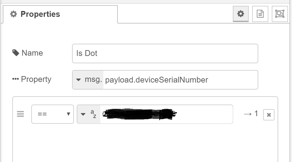

Or you could use msg.payload.deviceSerialNumber
Maybe leave your big switch where it is... but before it place another switch that only checks for the deviceserial # ... you only need to test for just the device you are interested in, the others can get discarded.

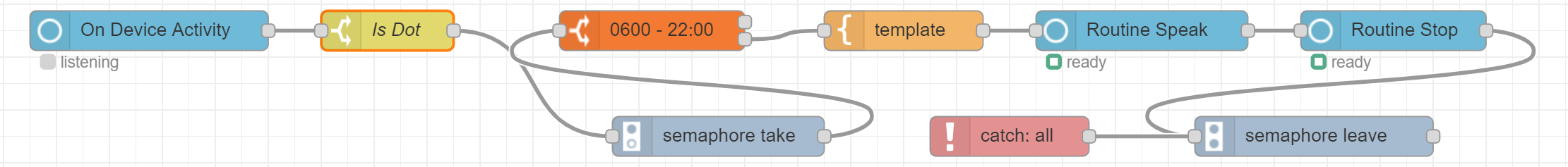

Like mine..
Note: I added a little message when my daughter tries to access - it whispers to her: "Alexa is available from 6 am to 10 pm. Please try back between those times."

This is the flow... it handles different aspects of the integration.
the on device activity basically does what the light sensor does, but with no delay. The second that dot lights up, the radio lights. This is my goal. So ... I've been pouring over the logs and can't find anything that will log the finished activity. It says successful at launch of an activity or question/story/weather/location. So putting these together without a generic delay might not be possible? The dot only stays lit for certain things. Weather, time . It seems she stays lit when answering a question, but when asking her to perform a skill, the light does not stay lit. This is where I need to bridge the gap. I hope this makes sense? I've confirmed that all of these work correctly independently, but on device activity doesn't turn off the light yet.
