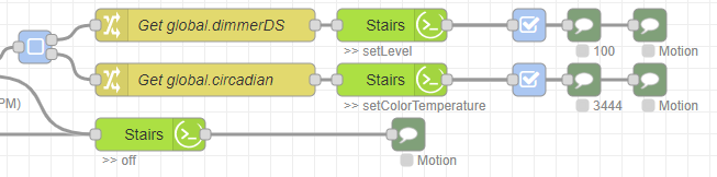

I have a bunch of Change nodes who's only purpose is to normalize the names. The Function can certainly accept the original names but I have two Thermostat drivers and I want a common Function.
Are you sure? The Command Node doesn't require that.. but maybe it's just that I commonly use two command nodes.

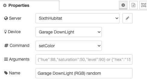

@csteele, I've been using Node-RED for over a year, and never noticed the three arguments for setColorTemparature. Thanks for pointing this out.
How would you get the color temperature AND level from global variables to enter into one command node?
Here's what I'm currently doing:
I feel that I could save some network traffic by sending these as one command, especially since I've got 75 lights updating with circadian and level.

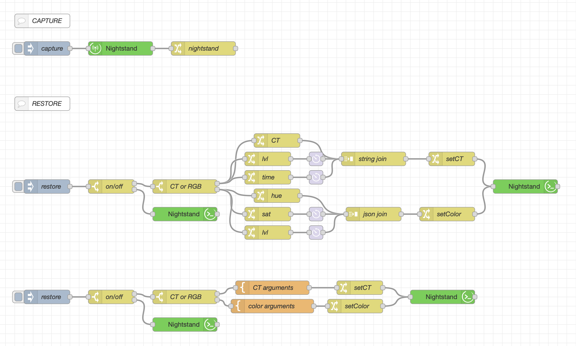

With NR, there are many ways to skin a cat. @csteele provided one method, using a function node, to set hue/saturation/level or colorTemp/level.
Here are two others in the context of a set of sequences that demonstrate how to capture the state of an RGBW device to a set of flow variables, and restore that captured state using the previously saved flow variables.
I've demonstrated two ways to pass H+S+L or CT+L to msg.arguments during the restore. The first method uses a join node. The second, which is cleaner, uses a template node.
Sequence that can be imported
