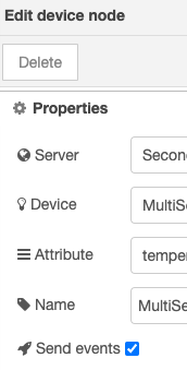

I am using node-red my devices - switches wont auto update. They will only update when i send a msg.attribute.
is there a way set this up
Make sure the Hubitat node has "Send Events" checked:

Since most of us create flows left to right, I'm going to say the left most node is most likely the flow initiator... the node that kicks things off. It needs that Send Events checked. Subsequent nodes do not. They are typically reacting to the msg from the initiator.
Screenshot 2022-12-24 at 9.59.00 PM
Screenshot 2022-12-24 at 9.58.44 PM
Solid box dangling below, left means it will send events, hollow means it won't.
If you wanted to have a door sensor turn on a light, only if it was off, then you might do something like:
Screenshot 2022-12-24 at 10.04.11 PM
Which would trigger BOTH on the door AND the Light changing. That would (depending on the logic that comes next) either keep the light on always or off always... not what you want.
Screenshot 2022-12-24 at 10.04.26 PM
So you turn off Send Events on the subsequent nodes to force the node to pass only the state of the light when the door changes.
