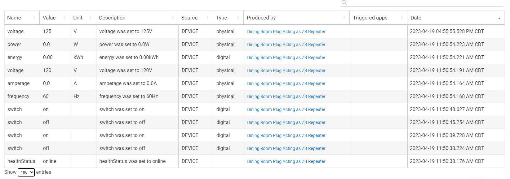

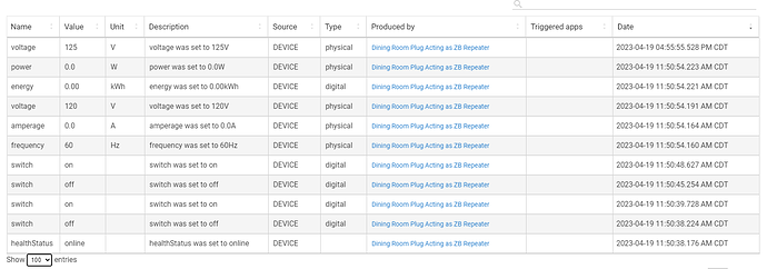

Here is one with no load on it, so not very chatty at all (basically hasn't reported anything since I paired it 5 hours ago):

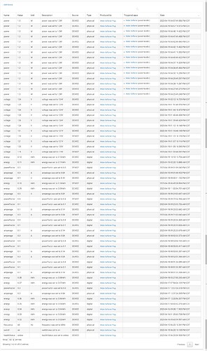

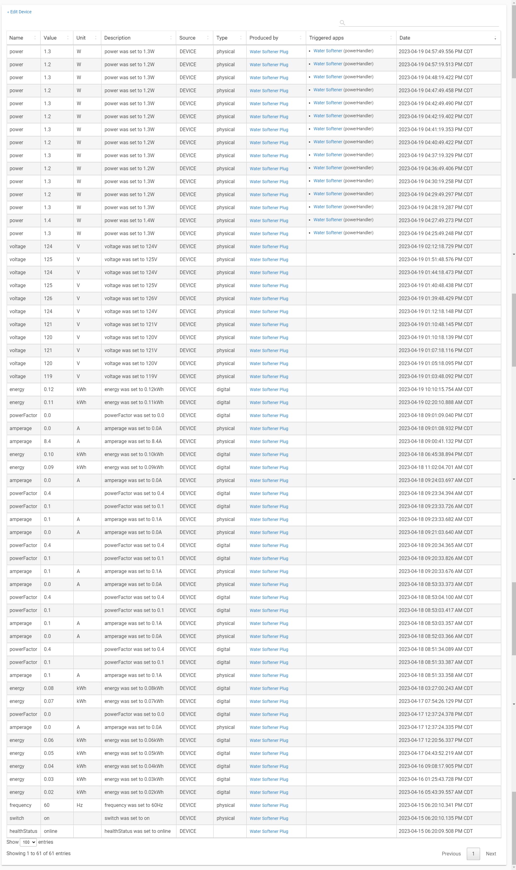

Here is one with a very small load on it (pretty chatty):

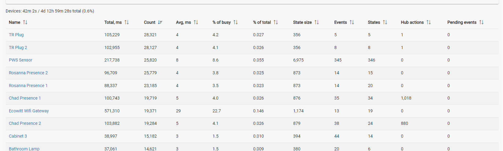

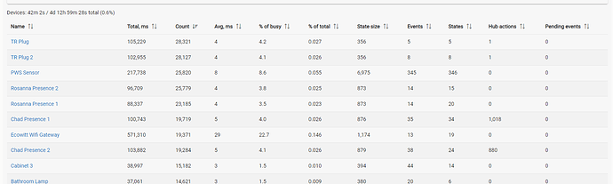

In addition to the above, here is something maybe worth noting. These, TR Plug and TR Plug 2, were paired a couple days ago and nothing is plugged into them, nor have they been turned on / off except for initial installation but they are the highest on the list of counts...Even more then my presence sensors. which check in a lot. I don't think it's an issue but maybe worth noting.
I am using the Generic Zigbee Outlet driver.
Wow, this is very interesting. Mine looks even worse and it's weird because there's very little/no correlation between the processing time and the number of events.
@Bullfrog Right! I am wondering whats going on behind the scenes with this plug, and if anything can be done about it, or if it even needs to be.

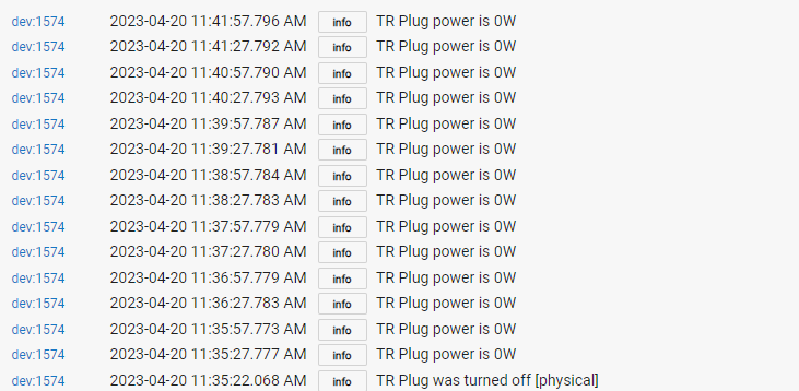

Dang it, tried a community driver and now they are reporting in every 30 seconds. Which I actually think they are doing this anyway. and is making the counts so high. Just with the generic driver it is not being reported in the logs maybe. So I switched to "device" cleared everything and then back to Generic Zigbee Outlet driver, but the power reporting of 0 Watts won't stop.
@ThirdReality is this something you can fix?
