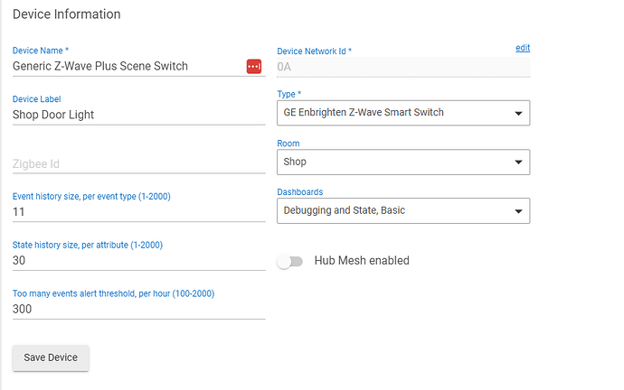

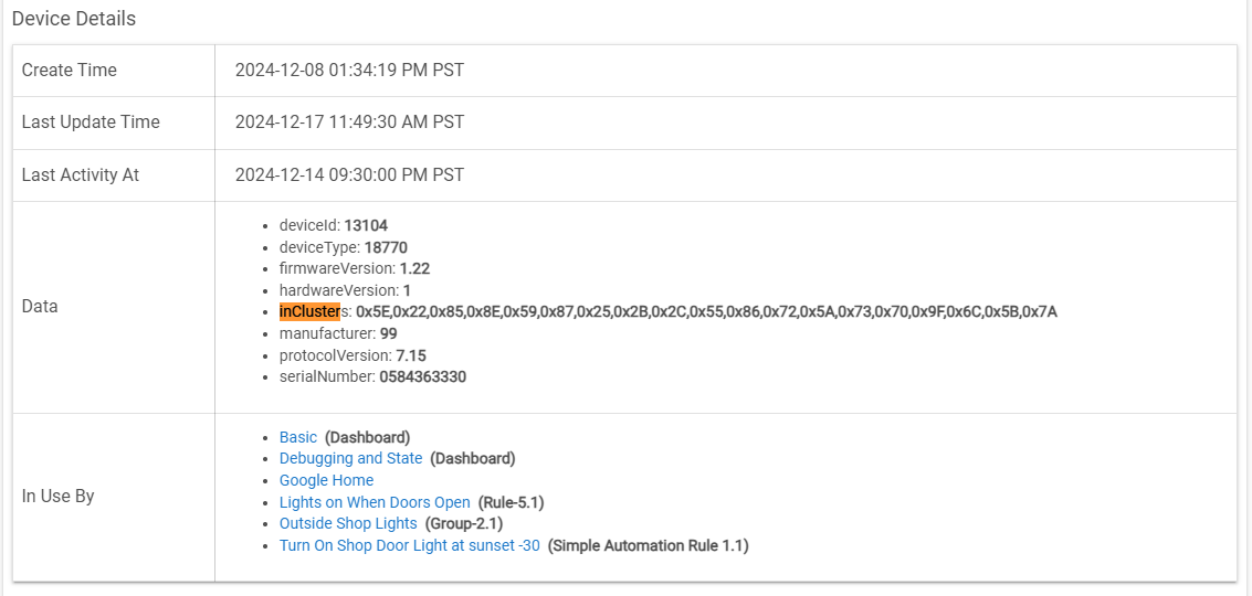

Please post a screenshot (not a copy/paste) of the bottom section of this device's settings page. In particular, the inClusters are what we need.
Also please list the exact name of the driver (Type) that this device is currently using. Probably something like Generic Z-wave Switch or similar.

Oh there are tons of different ge / jasco drivers to the point where it’s hard to know which one to even use anymore. You might just have it set to one for an older device so it’s not picking up the events. I would just try my universal driver pack, it works on all the newer 700 or 800 series GE and Jasco switches and dimmers.
And the inClusters? Could you give us those?
Like @jtp10181 says above, the names are kinda confusing, there are so many similar ones. You should likely try and use a different driver. Knowing if this is really a Z-wave plus switch (I think it is) might narrow down what to try.
His drivers are pretty solid, but I don't think they work on the older devices. There are other community drivers for older Enbrighten switches that also work good and are less confusing than some of the built in drivers.

That is definitely Z-wave plus, the 0x5e gives it away.

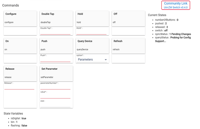

I didn't hit configure, I just hit save, I have now tried both the GE Embrighten one and the Generic ZWave Plus switch drive and hit save, then hit configure, in neither case does the switch start to report back it's status.
then I downloaded the universal drivers and installed them, switched it to that driver did "Save" and then pressed the "Configure" button and again no status updates, despite the light turning on and off, the page looks like this:
I can't say for sure how that universal driver is supposed to act. Typically though, you would configure, and I can't remember if you have to hit save, (won't hurt to try) but it should at some point pop up some new items on that screen just below your screenshot. Rereading the driver documentation, it should show the progress in the upper right corner in States. It should prompt you to refresh and save at some point.
It should in that middle section list the settings the switch has like if it has an LED there would be the settings for it, or if this were a dimmer, how long it takes to dim. From there, you could set/configure those settings, and save again.
To me, it almost acts like the switch didn't pair properly upon replace? Or like something is messed up and the switch thinks it is something that it is not?
Some 30 minutes later it's still says "syncStatus: 1 Pending Changes" the switch physically looks correct as a 58436 Enbrighten switch, including the "air gap" switch under it you can only reach when the cover is off.
