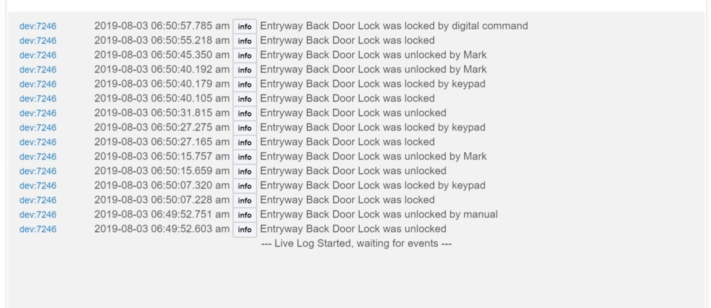

Unfortunately my issue with lock code triggers doesn't seem to be resolved using the Kwikset 914 Zigbee model either. Initially it was working as I expected but now the lock code events are not being shown in the device driver event log and the rules are no longer triggering. The live logging does show the lock code event though, strange.
Starting to think it may be an issue with the generic zigbee lock driver? @mike.maxwell

All of these unlocks were by the the keypad, as you can see none of the device events are showing "unlocked by xx" instead just "unlocked"
Live logging shows like this:
Lock code manager report looks like this after clearing it and then unlocking it with a valid code several times:
Can you pm me the live logs with debug logging turned on, then an unlock from the keypad using a code?
Debug logging for the lock or LCM or both?
Just the lock, I only need the lock logs.
