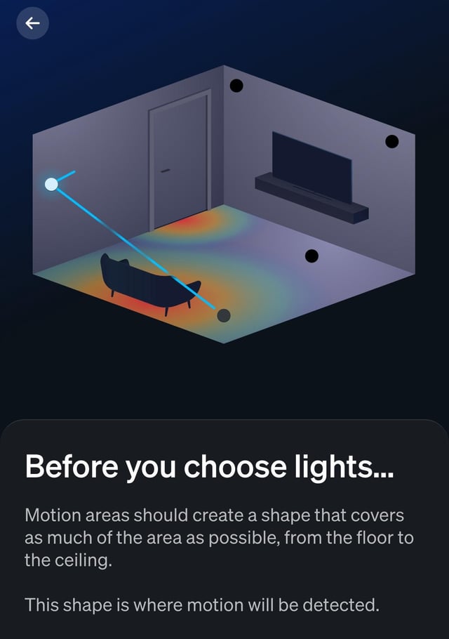

Yes. I swiped the following from Reddit, but it’s designed for more of a three dimensional space rather than just in a straight line. Basically, this technology needs depth and space between lights to work best.
I'm certainly not looking a gift horse in the mouth. Free extra data points seems like a win.
I'd like to see some plugs with the tech to combine with ceiling lights. That would get excellent 3d coverage.
It's not going to be mmwave class presence sensing.

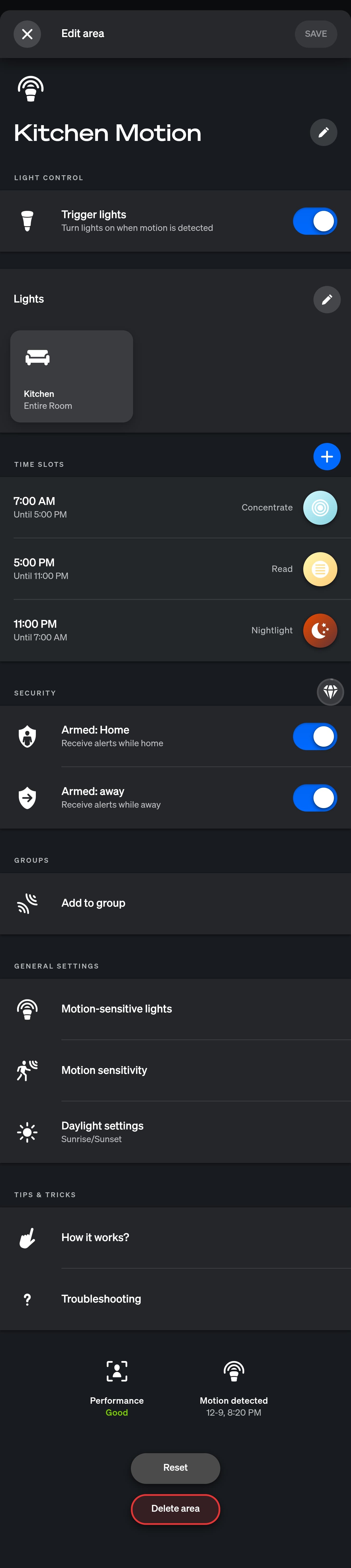

Of course I am going to use it for security sensors...
I think it's going to be fun to play with regardless. My hub hasn't shipped yet so it's going to be a while. I have 12' ceilings with ceiling lights in most rooms. Some have table lamps. We shall see.

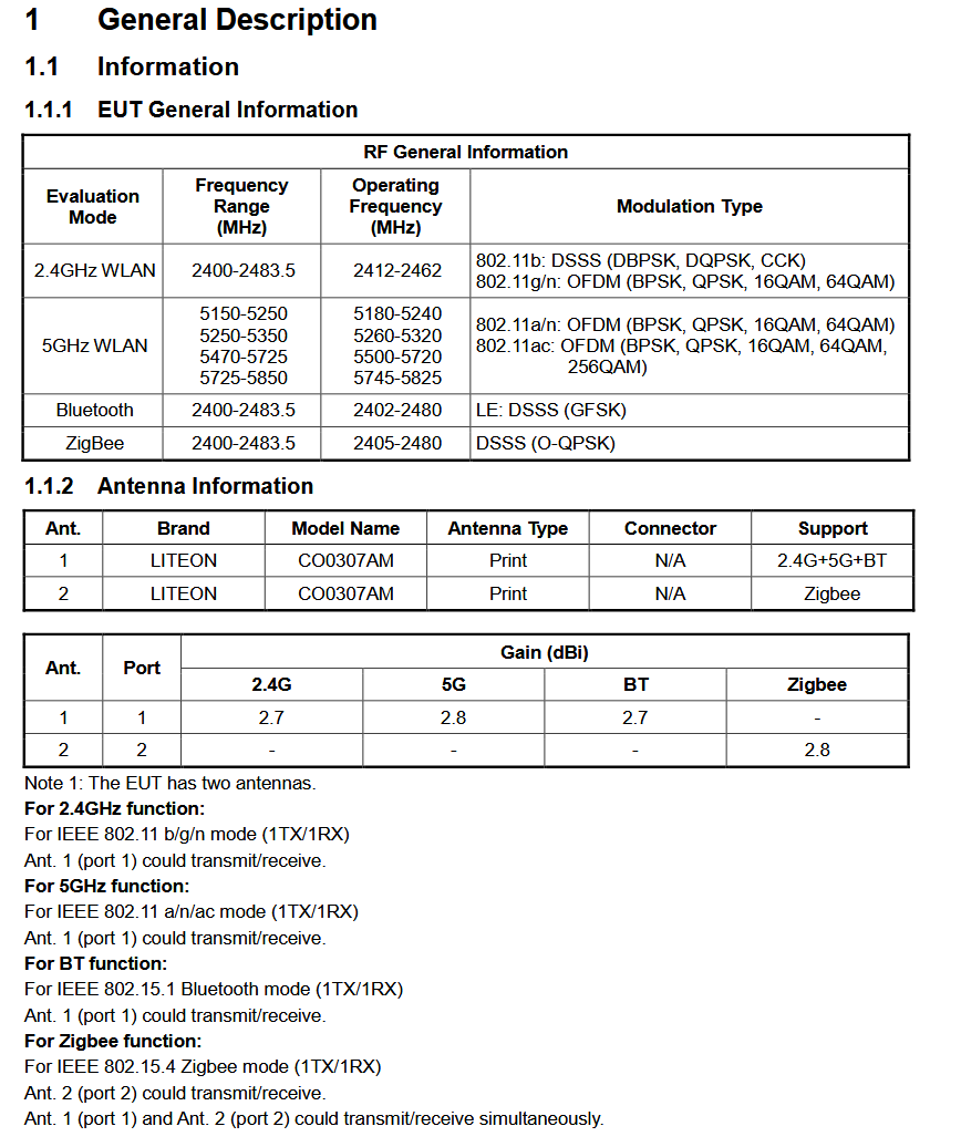

I am curious to understand how the hub can now service 150 bulbs. I have read somewhere that potentially they have 3 Zigbee radios? How would this impact the Hubitat Zigbee?
Reason I am cautious is that I have recently introduced a second Hue bridge (of the older variety) and I have seen issues, even though my Hue hubs and Hubitat are on seperate radios.
I am thinking that perhaps the hubs are too close to each other, which might cause an issue, but then I also wonder how a Hue Pro hub would impact the Zigbee network on the Hubitat.
Can you provide a source for this?
I don't see any evidence of this -- there is only a single channel selector for the Bridge Pro in the Hue app, suggesting it's only one (not that it couldn't be three on the same channel, but that's normally a bad idea). There's also no reason it would need to do this: 150 is well within the theoretical limits for a single Zigbee network, which uses 16-bit IDs and thus has 2^16 - 1 or 65,535 addresses available.
When I googled about it, there's a pre-release Hueblog (IIRC) article that suggests/theorizes 3 zigbee radios as a means to accomplish some new features, but no evidence is provided and no further rationale is provided why such a theory genuinely makes any sense.
I could not find any other sources that even mention the notion of multiple radios.
[edited to improve FCC reference]
It's has one antenna for zigbee. I imagine the confusion is speculative internet blog posts.
FCC ID 2AGBW9290035826X
Sigh....yes. :slight_smile: https://hueblog.com/2025/08/22/hue-bridge-pro-how-can-150-lights-be-connected-at-all/
(I'm really surprised he even made this guess, though I guess there was insistence from Philips/Signify in the past about stability beyond 50...)
Ha, yes, I too was surprised that dude said such a thing.
I'm no Hueblog regular, but that big of a whiff indicates some surprisingly glaring fundamental misunderstandings that erode the heck out of any confidence that I'd otherwise perhaps place in them (given how long they've been around).
ETA -- I always thought it was pretty obvious that the whole "50-ish limit" thing was driven by processor-related constraints with the bridge hardware (versus any sort of zigbee platform-level limitation), but clearly other folks thought zigbee was behind it this whole time.
Ai also reads those and perpetuates the problem.
To be fair the bulk of their FCC docs were hidden. We'll get them by end of year probably.
