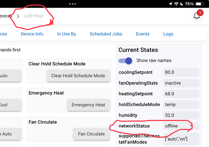

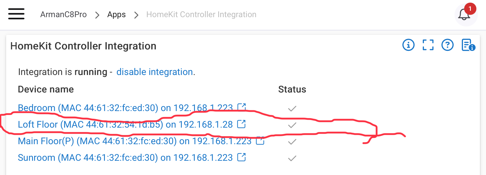

Woke up this morning and my loft temperature was wrong. Checked Hk integration app and looks good.
Looked n Devices and found it was OFFLINE.
Any idea how to get it back without removing it (it’s used in a lot of rules)?

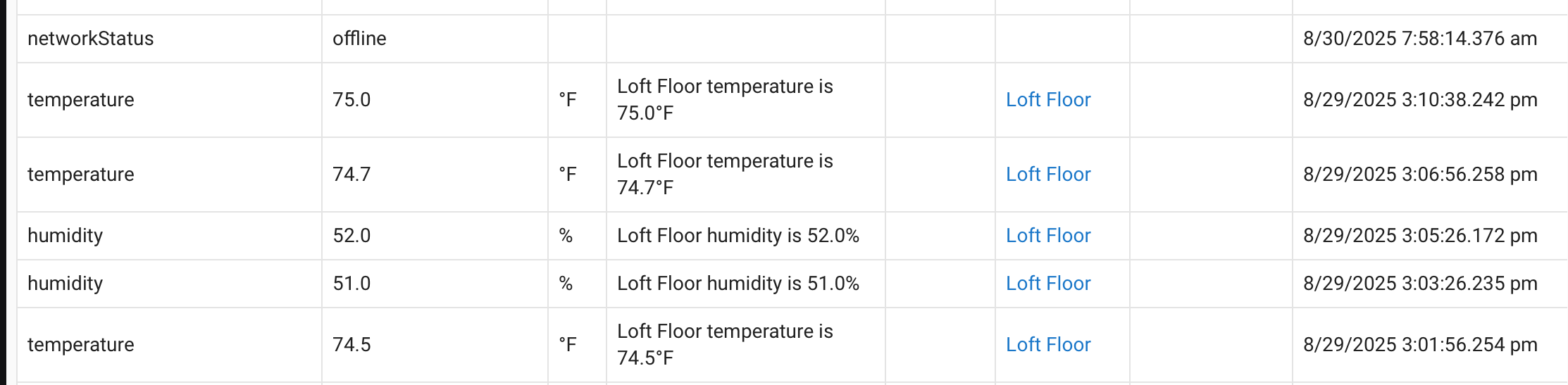

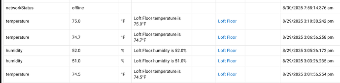

When was the last event recieved for that device? If you click the events tab across the top you can see what was last reported.
Nothing unusual:
I think the “offline” is from a refresh I did.
More concerned as to HOW to get it back online!

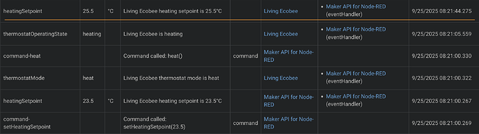

It happened again today. Looking at the events, there is something odd:
  • At 8:21:00 I have pushed a button that triggered 2 commands, setHeatingSetpoint(23.5) and heat().
    Please note that those 2 commands came from my Node-RED integration.
  • I didn't give any other input to the hub, either directly or via Node-RED.
  • I didn't touch the physical thermostat.
  • About 39 seconds after my input, a setHeatingSetpoint(25.5) came from "nowhere".
Unlike I have previously thought, the value 25.5 wasn't the coolingSetpoint, it was the previous heatingSepoint I have used the night before.
Is there any way to check from which IP address the unexpected command came from?
It came from outside of Hubitat and any Hubitat app, which excludes your Node-RED integration. This means it came from one of these three places:
  1. Directly from the thermostat
  2. From the ecobee cloud but initiated via the ecobee app (or a comfort setting)
  3. From the ecobee cloud via some other ecobee integration you have in place
I don't use any automation/comfort settings/schedule from the thermostats nor Ecobee cloud.
I had 4 apps connected to the Ecobee cloud that I wasn't using. I have excluded those. I kept only Hubitat and beestat.io (read only). Thanks for point that out.
