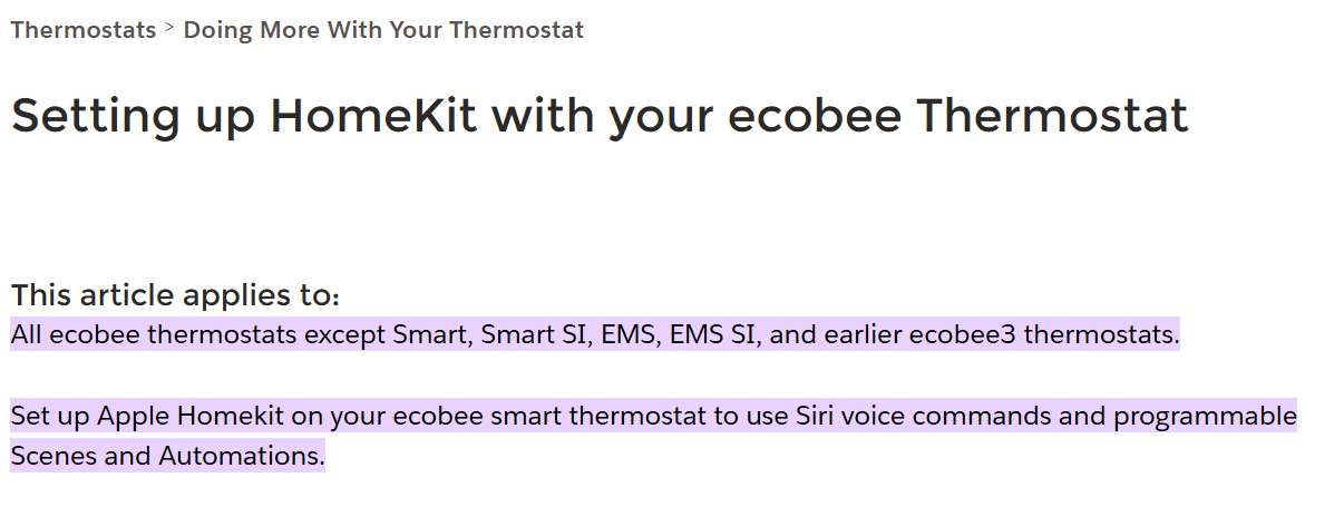

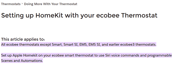

Curious: what spec, version(?), does the Ecobee thermostat have to have?
I've got an old one.
Thanks.
Pretty sure it's common to the Ecobee 3 or later (basically all their tstats for the last 11 years).
I know that my Ecobee 3 Lite thermostats have HomeKit support. But I have no idea of when Ecobee added that as a standard feature.
Here is a snippet from Ecobee's website
Thanks.
I have a Smart Si, 3.4.4.179
Doesn't look good. :frowning:
