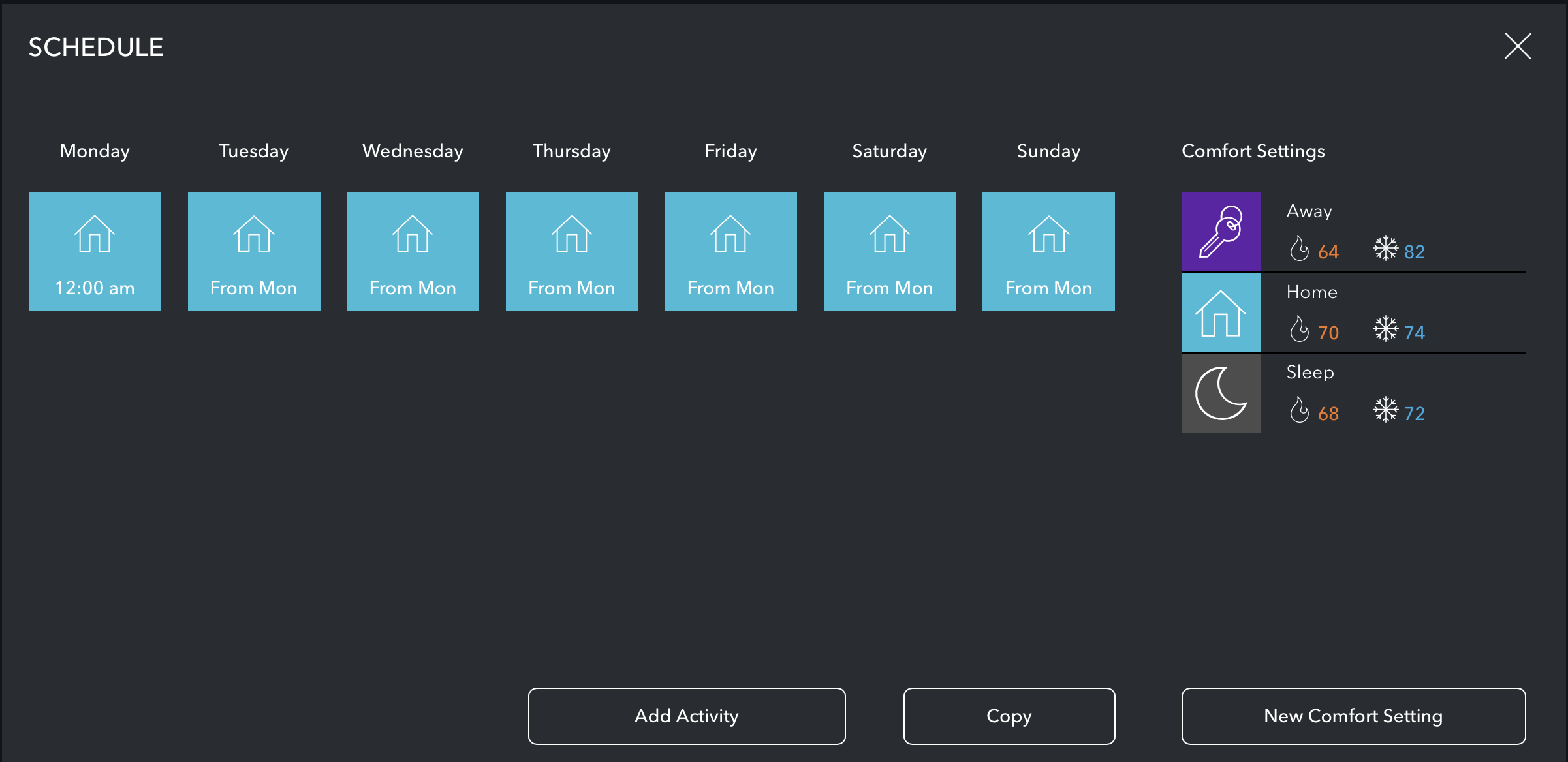

"Solution": On my automation, after setting the set point and turning heat on, I've added 1 minute delay and an action to set the set point again.
How did you disable the schedule? AFAICT, this cannot be done directly. Here's what I did a long time ago, and after doing that have not experienced the mystery temperature changes you described ....
Is it always 2 degrees difference? Might want to check the settings on your thermostat and adjust the minimum degrees difference between cooling and heating. If you set the heating at 23.5 while cooling is 23.5 AND you have the minimum 2 degrees difference, then the thermostat will adjust the set temperature accordingly (2 degrees difference, or whatever your minimum is).
My understanding is that if you have Hold Action: Until I change it, it ignores the schedule. Anyway, I'll apply your recommended schedule.
