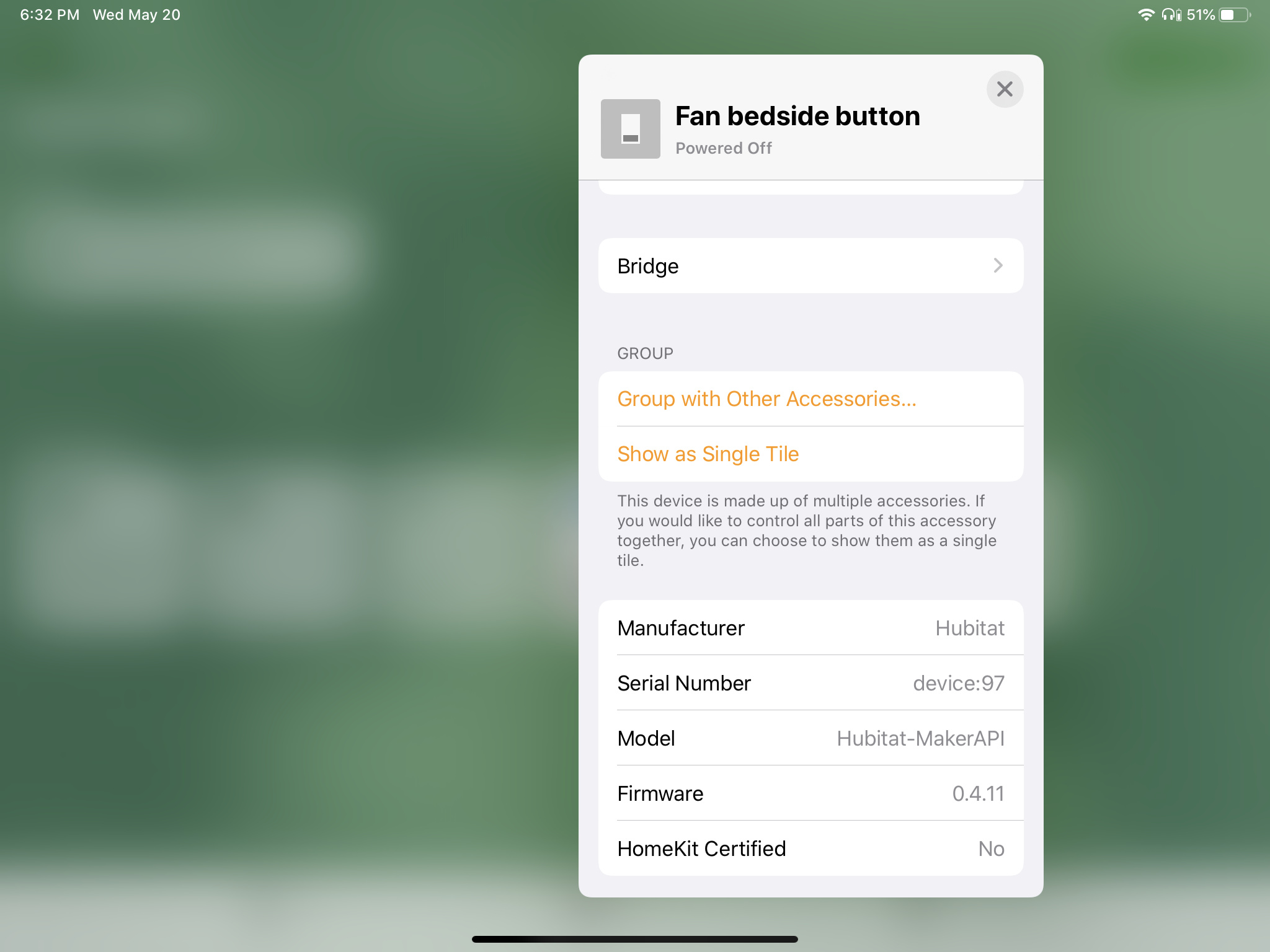

@dan.t @ogiewon @marktheknife @bertabcd1234 do you see the mistake Iâve made that the switch wonât âhide?â
Thank you
I see your mistake...just put the device id number only. I would use lowercase for the capability (not sure it matters but that's how I see them listed in the readme).
So try:
"excluded_capabilities": {
"97": [
"switch"
be sure to restart homebridge or wait until it refreshes (I think the default it 5 minutes)
Have you tried using Danâs tool https://dantapps.github.io/
Hmmm...maybe try using exclude_attributes instead?
"excluded_attributes" : {
"97" : [ "switch"]
No go
Thx, just did, no go
Itâs probably something obvious too, lol. Oh well, I guess itâs fine
