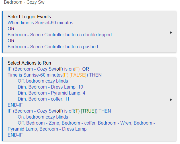

So, got a new C-7 and have been active the last couple weeks trying to move things over slowly.
So far so good, till this morning when doing a double-tap on a button controller broke our world. The button was double tapped once, then we started seeing lights associated with the rule not responding as expected. Looking into the logs about a half hour later the following loop was scrolling faster than I could read. Managed to copy a bit of if. Could not figure out how to stop the madness so initiated a reboot after pulling the batteries from the button controller to see if that had fried. Hub hasn't been seen since (1/2hr). Any idea what to do now? And no, port 8081 does nothing.
Here's the sort-of-repeating loop from the log:
