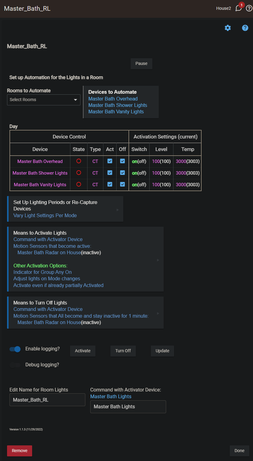

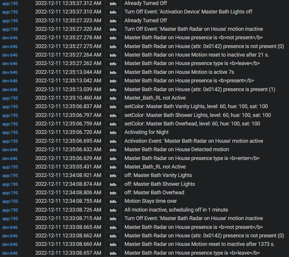

I have a weird one and, of course, I don't have the full gambit of logging to figure out what went wrong. For some reason, when the RL instance went active at 12:35, the status did not update to "active" but the lights were on. When motion stopped, the RL instance didn't schedule turning the lights off, I presume since the RL instance was already "off".
Show the app set up page.
Will the RL instance show "not active" until the lights report back? Maybe there was a delay in the table updating that caused the problem. Looking over the logs again, I see that the instance did finally flip to "active" at 12:36:05...almost a full minute after the activation even at 12:35:06. The two events to turn the lights off just happened to come in during that one minute window.
RL Setup

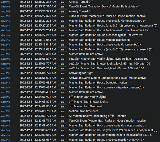

I realized I should have included everything in the logs:
Logs
And the app setup page. Does this have an Activator device?
My bad. It does. Updated the screenshot above.
Just add Turning Off option to Turn Off even if partially off, and see if that fixes it.
