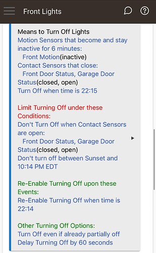

I have a front light switch that I had multiple rules for that I thought RL would consolidate but so far it’s giving me trouble. I would like to:
Have the light go on at sunset and off at 1015pm. Nothing should change that.
Between 1015 an sunrise I want the light to go on:
If motion is detected in the front. Then turn off after 6 minutes unless the garage or front door are open
If the garage or front door is open and not go off until they are closed.
The light only does these things if it is between sunset and sunrise. Otherwise they do nothing.
Does this look right? Currently they don’t stay on from sunset until 1015.
