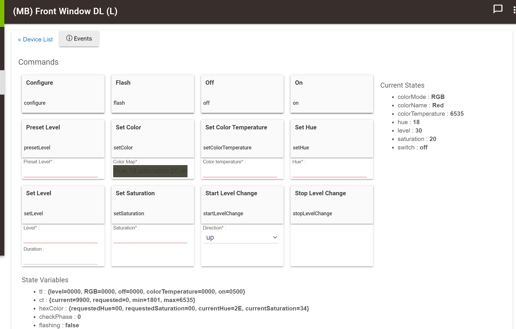

please ensure you select the correct driver. IE if RGB then RGB if CT then CT and if both then RGBW. once saved fill in your preferences then save them.
Then open the logs in another tab and hit configure on the driver. You will see the lamp go crazy and do a load of tests. once it goes blue its completed. Then refresh the driver page you will see a load of state information has now been filled in.

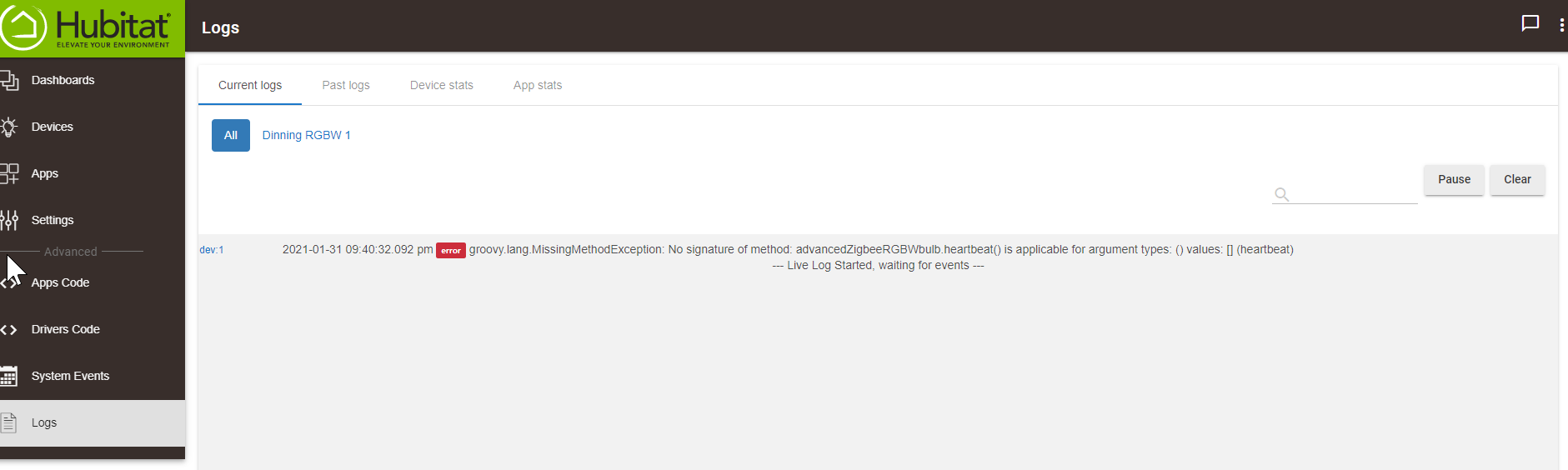

cant seem to see the configure button, gone into logs and its just says dev:1 error
I (and several others) have reported using these successfully w/Sengled bulbs, color and white-only. They actually work better for me than the Sengled driver, bulb reacts faster and is more reliable.
in the device page.
Cheers @BorrisTheCat i had found that just before your post..... Good news is that they work, bad news is that i'm still not happy with them they just dont match the colour temperature and the colour rendering is way off a 4000k equivalent static colour Aurora GU10(that they are next to) - considering its marketed as an RGBW and CT lamp i didnt expect to be able to see the RGB Chips lit up
