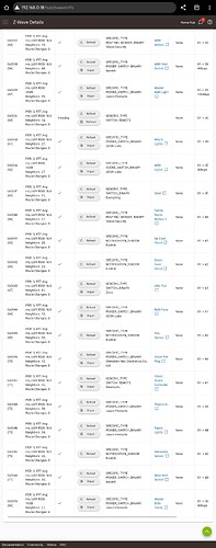

I was able to remove three ghosts, one of them was able to successfully match up to a device that was having trouble pairing. It took a few tries as they would disappear but come right back again. I'm still left with one device that will not go away, I do think it is related to a specific switch that I have, I tried removing it with that switch powered off but it still comes back. Either way after removing all the ghosts the network was back up to full responsiveness and stayed that way all evening. Overnight however it seems to have reverted to big delays. Here is my latest device list.
Can you re post with ALL the columns?

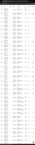

Sorry about that, see attached, I couldn't get the last column on my phone, if you need it I'll have to get it from the computer soon.
That one pending device just won't respond to the remove command.
60 is still a ghost. Once you get rid of that one, shut down the hub via settings, then unplug power to the hub for 1 minute and power back up. Wait about 10 mins and see how things behave. Then update to the latest platform (settings, check for updates)
Personally, I would be less interested in continuing to try and remove the one ghost node. I would be more interested in seeing the full details page after 12-24hrs of uptime so I can see the stats for each device. Make sure you click the "Refresh Stats" button before the screenshot. Also specify how long since last reboot when you post it.
