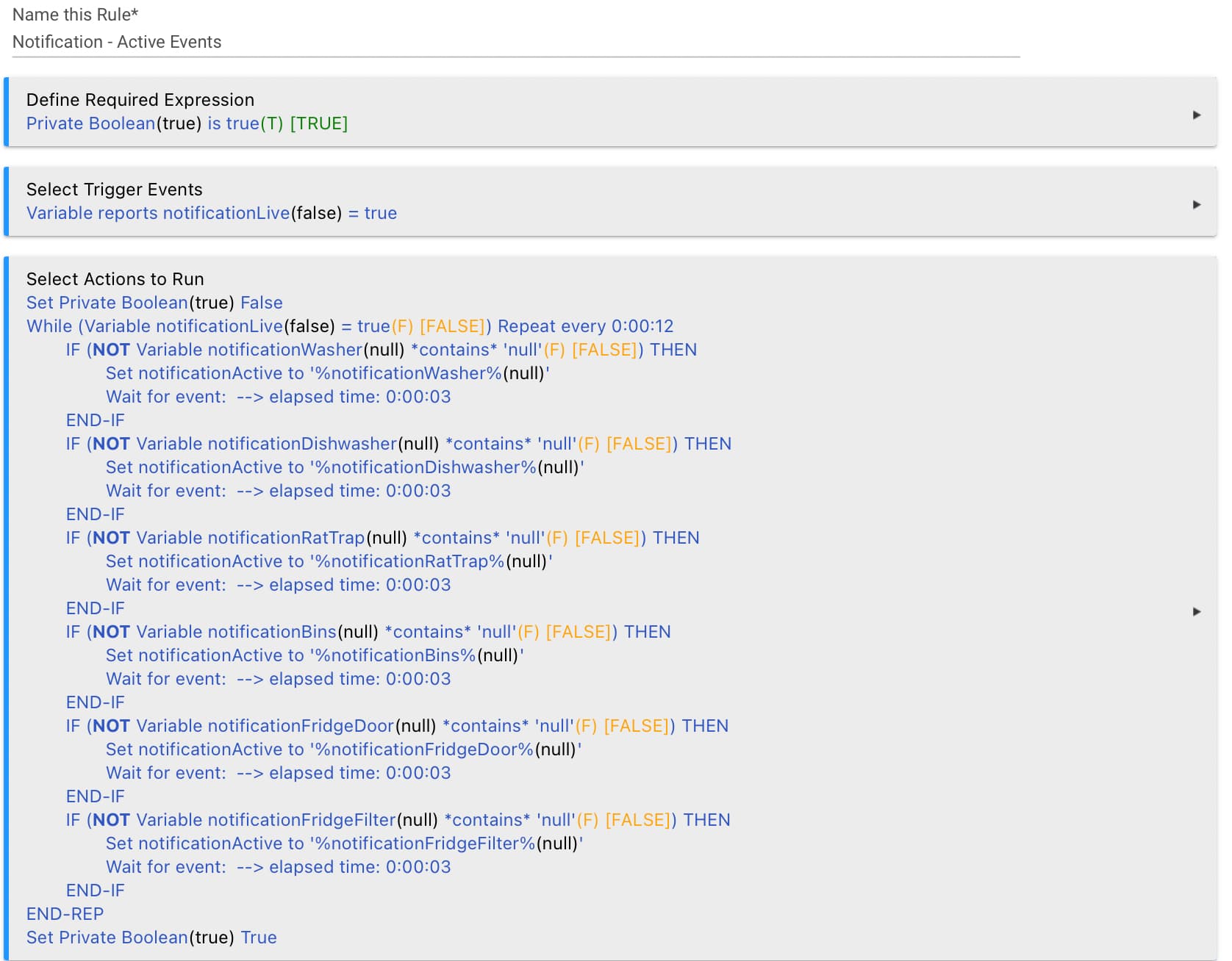

I'm wondering if anyone has developed or is aware of an app/driver that can display multiple alerts on a dashboard tile? In order to do this I'm having to use multiple rules and variables. It works but it's very clunky and a bit of a mess on to add additional alerts to. To explain what I'm looking for, it might be easier to explain/show what I've done to achieve it with Rule Machine. This was also discussed in another post when I first set this up:
For each alert that I want to display I have an individual rule and a global variable. When the rule is triggered, it populates it's global variable with %time% - %alert_goes_here%. When the condition is cleared the variable is set to null in the rule. I have a number of these rules - one for each alert (put the bins out, washing complete, dishwasher complete, get outta here the house is on fire etc). All of these alert rules also run the actions from a second rule, both when the alert condition activates and when it clears....
The second rule (with no triggers) has conditions to check each of the variables. If any string is populated with anything, it sets another global variable (notificationLive) to true, otherwise it sets it to false.
A third rule is triggered by the notificationLive variable above changing. When true it looks at each variable from the individual rules in step 1 and if there's a string in that variable it populates ANOTHER variable (notificationActive) with the contents, waits a few seconds and moves on to the next.
The end result that I have a dashboard tile that remains blank until one or more event rule triggers. Then it scrolls through each alert continually and doesn't clear until there are no active events.
What would be great, would be an app or maybe device driver that handled this, so that I only needed my individual rules for the alerts and could send that alert to another device for display rather than messing around with so many rules and variables.

Thanks for the info. What I'm doing at the moment with RM is to have any active alert permanently displayed until it clears and if there is more than one alert (generated by my individual rules) it switches between them very few seconds. When all are clear the tile goes blank (as the variable gets set to null). In order for the notification to clear - the rule that generated it in the first instance will set it's associated variable to null, rerun the actions in the second rule, which will then set the variable on the dash to null. It's important the way I've done this that each rule successfully clears when the condition ends as I've no means to clear it manually other than mess around with the variables (I'll probably have to write another rule with a virtual button trigger to set all variables to null and reset booleans where necessary!). For instance - I've just got in and the Dishwasher Program Complete triggered:

@johnwill1 - I don't suppose you've made any progress on this? I'm a very basic user compared to you guys - but I've been trying to figure out a solution to the exact same question as you....how to display multiple alerts on a dashboard tile..... my only additional complication is that I'm using a sharp tools dashboard, so I'm trying to figure out a way to pull it all together!
I haven't. I'm still using multiple RM rules as detailed in the top post. It works but it's a PITA. I'm surprised that something (an app or means to do this via rule machine) isn't available. I'd imagine it would be very useful to many.

What I'm trying to do is replace the mess of rules I have at the moment, but get a similar end result to what I've got working.
The starting point is an empty tile on the dashboard. When one of my RM rules for something I need a warning for (or just a notification) triggers, it writes to a variable that displays within a tile. If a second, third, fourth rule create a warning, the variable tile will switch to display each individual alert in sequence continuously - message 1 (3 seconds pause), message 2 (3 second pause), message 3 (3 second pause) and so on in a continuous loop. As each rule clears it's own variable (example - the laundry rule that creates '15:37 - Wash Cycle Complete' will empty its string variable when I open the washer door for more than 10 seconds), that particular alert will no longer display in the sequence. When all alerts have cleared, the tile is empty again. What I have works but is overly complicated/not scalable for more than a few different alerts.

I could make the Notification Tile do something close to that but it would be better/cleaner to write something a little more specific for the use case. How many messages are you thinking would be active at a time?
I imagine that even as I add rules that will create alerts it would be unlikely unlikely to have more than 5 ever active at the same time. If my wife comes home and the tile is cycling "Wash Cycle Complete", "Dishwasher Complete", "Put the bins out" - I'm in for some serious grief
I suppose it boils down to what other users would find useful, but for me I'd never exceed 5.

What we are looking for is a single target device tile (or variable) for unconnected RM rules. It needs to enable a single tile to display an alert while active and sequence through them when there are more than one.
So far as I’m aware there is currently no Hubitat or a community device app that will do this easily (though my awfully unmaintainable RM rules do)
Default cycle time is 3 seconds, but can be changed with a preference. If debug is turned on it will turn itself off after 30 minutes. Messages will be cycled into the html parameter, which can be displayed on the dashboard using an attribute tile template.
The commands for the device will be under custom commands for RM, device capability Actuator
Commands addMessage(String messageID, String messageContents)
Used to add or modify a message string
The addMessage command takes 2 parameters: messageID - short identifier for the message (no special characters) messageContents - actual message you want the device to serve up
To modify a message use the same messageID as the message previously entered and put the new content in the messageContents parameter

Very nice! Tried it out with my Hubitat Dashboard for Android and looks like it will suit my needs perfectly. However it seems that using 'Rem Message' (using the button from the device page) with any single message ID clears them all. I was thinking it would delete the one specified from the rotation.
