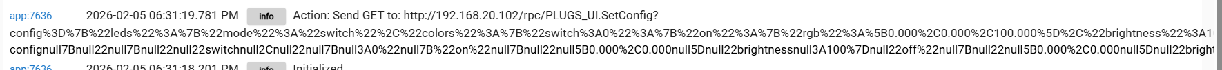

Any ideas why the full URL wouldn't? On two different hubs, different models, this seems unlikely to be a database corruption issue. Other things are all running normally. Weird.
Tried the full URL again and failed again. Totally confused here. :wink:
I cannot see the full URL in your screenshot. Just spitballing, can you double-check you are ending with a bracket and not a bracket plus a close parentheses?
E.g.
Not
might try it with a URLencode, i.e.
http://192.168.20.102/rpc/PLUGS_UI.SetConfig?config%3D%7B%22leds%22%3A%7B%22mode%22%3A%22switch%22%2C%22colors%22%3A%7B%22switch%3A0%22%3A%7B%22on%22%3A%7B%22rgb%22%3A%5B0.000%2C0.000%2C100.000%5D%2C%22brightness%22%3A100%7D%2C%22off%22%3A%7B%22rgb%22%3A%5B0.000%2C0.000%2C100.000%5D%2C%22brightness%22%3A100%7Dhttp%3A%2F%2F192.168.20.102%2Frpc%2FPLUGS_UI.SetConfig%3Fconfig%3D%7B%22leds%22%3A%7B%22mode%22%3A%22switch%22%2C%22colors%22%3A%7B%22switch%3A0%22%3A%7B%22on%22%3A%7B%22rgb%22%3A%5B0.000%2C0.000%2C100.000%5D%2C%22brightness%22%3A100%7D%2C%22off%22%3A%7B%22rgb%22%3A%5B0.000%2C0.000%2C100.000%5D%2C%22brightness%22%3A100%7D
Thanks for asking...ends in three brackets:
http://192.168.20.102/rpc/PLUGS_UI.SetConfig?config={"leds":{"mode":"switch","colors":{"switch:0":{"on":{"rgb":[0.000,0.000,100.000],"brightness":100},"off":{"rgb":[0.000,0.000,100.000],"brightness":100}},"power":{"brightness":100}},"night_mode":{"enable":false,"brightness":10,"active_between":["00:00","00:00"]}},"controls":{"switch:0":{"in_mode":"detached"}}}
Dan tried this I believe based on what he posted above.
Try that and see if it saves
Not happening, unfortunately...at least in RM:
But saved without error? Just trying to get to the crux of the issue.
I'll give that a try. The problem may be that it will save, but it won't complete the necessary action on the Shelly plug. The URL including three brackets at the end does function properly when executed from a browser. Leaving the brackets off may end up with broken plug functionality even if Dan's momentary switch app can save it in that format. :man_shrugging:
Yup, saves but doesn't execute properly from @ogiewon's momentary switch app. No change in plug LED color, and errors in the logs.
I meant saved okay in Dan's app.
To summarize, the issue is that the GET URLs required by the Shelly plug have brackets in them that rule machine strips out. When that happens the Shelly GET URLs don't work.
There doesn't appear to be an easy workaround for the issue with Rule Machine stripping out the brackets, short of some sort of update of room machine from HE staff, who are understandably busy with the current platform beta. And so far, of the three apps I've tried that provide GET calls, none of them work with the Shelly URL either.
