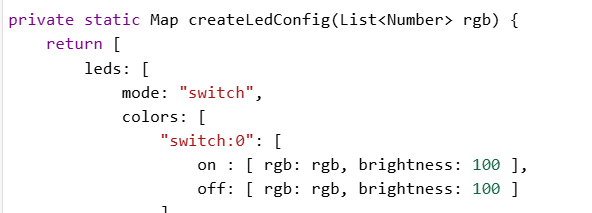

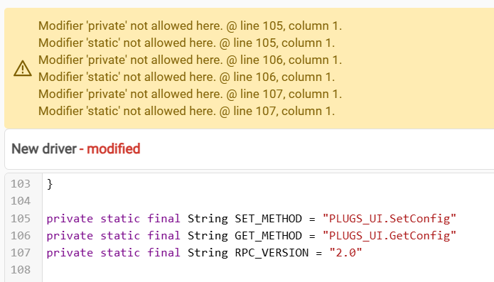

Compiled after removal of “private static” from these three lines.

Looks like Claude didn't actually try to use his code? :wink:
I removed the bracket on line 51, and then...
For Claude's code to work you'll need to make the changes that @TArman posted.
Yes, DOH, did so just after I posted and it compiled. Was wondering if the other instances of private static in the code also needed to be excised, but it did compile/run w/out doing that. :slight_smile:

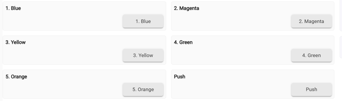

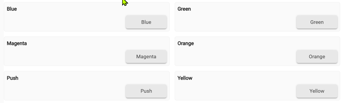

So now change all those stupid command names, Mr. Programmer.
I guess they don't need numbers & names, I'll remove the numbers.
I expect cake at the induction ceremony this weekend.
What's w/that extra "push" button?

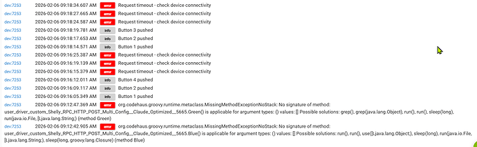

First try just now actually using the driver.
Claude didn't like how I renamed the buttons (first log entries below) so I reverted that.
Now getting time-out messages. Went back to ChatGPT version from last night and it's working fine. So maybe Claude is a little big for his britches? :wink:
First two entries from Claude version w/buttons renamed. All others from reverted version w/original button names. Not working... :frowning: And not a general connectivity/communication issue as using the ChatGPT version from last night colors change immediately when I click the buttons in that driver.

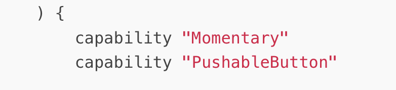

Commenting out these two lines should remove the “push” button.
Thanks. Not sure what to do about the request time-out. Might have to ask ChattyGPT as I dont' think I have access to Claude. :slight_smile:
Did you set the proper IP in the preferences?
Yup - was actually already set to my Shelly plug's IP by Claude. :slight_smile:
Taking tatt suggestions?
Did you try the original Claude version with just those three lines fixed and the metadata with curly brace added to top?
Maybe it was one of your changes that introduced an error🤔
