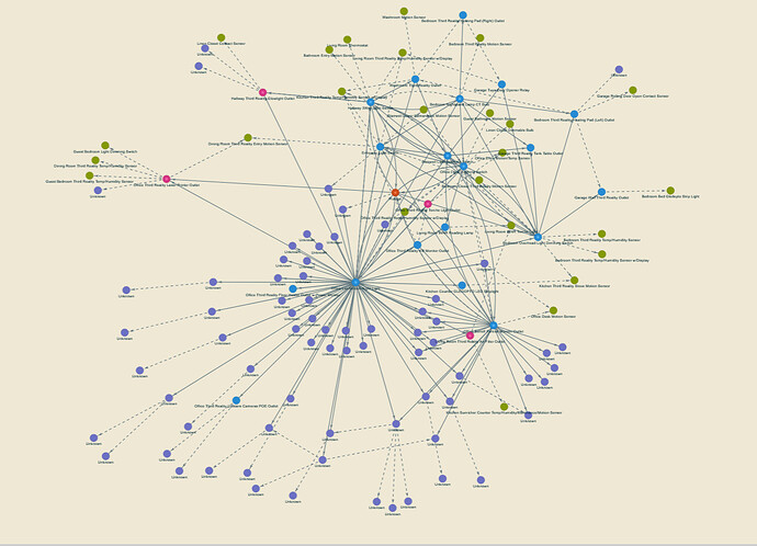

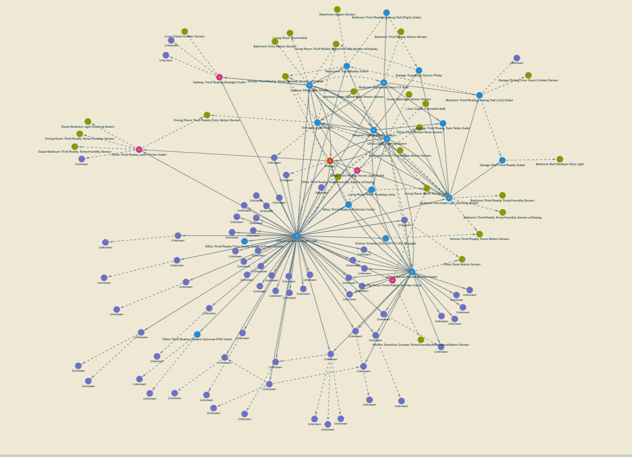

Not seeking assistance yet - just posting but when my ZB went sideways, it REALLY went sideways. more than 1/2 my devices are 'unknown'.

Not a suggestion, but I have gone to the extreme of resetting entire radio and manually readding all (56) of my devices a few times over last 10 years. But in a couple of those experiences I would get to a point where a "bad" device getting added started the problem and then I had to eliminate it/them and do it all again. Again, not a suggestion for you, just an extreme I have suffered through a few times.

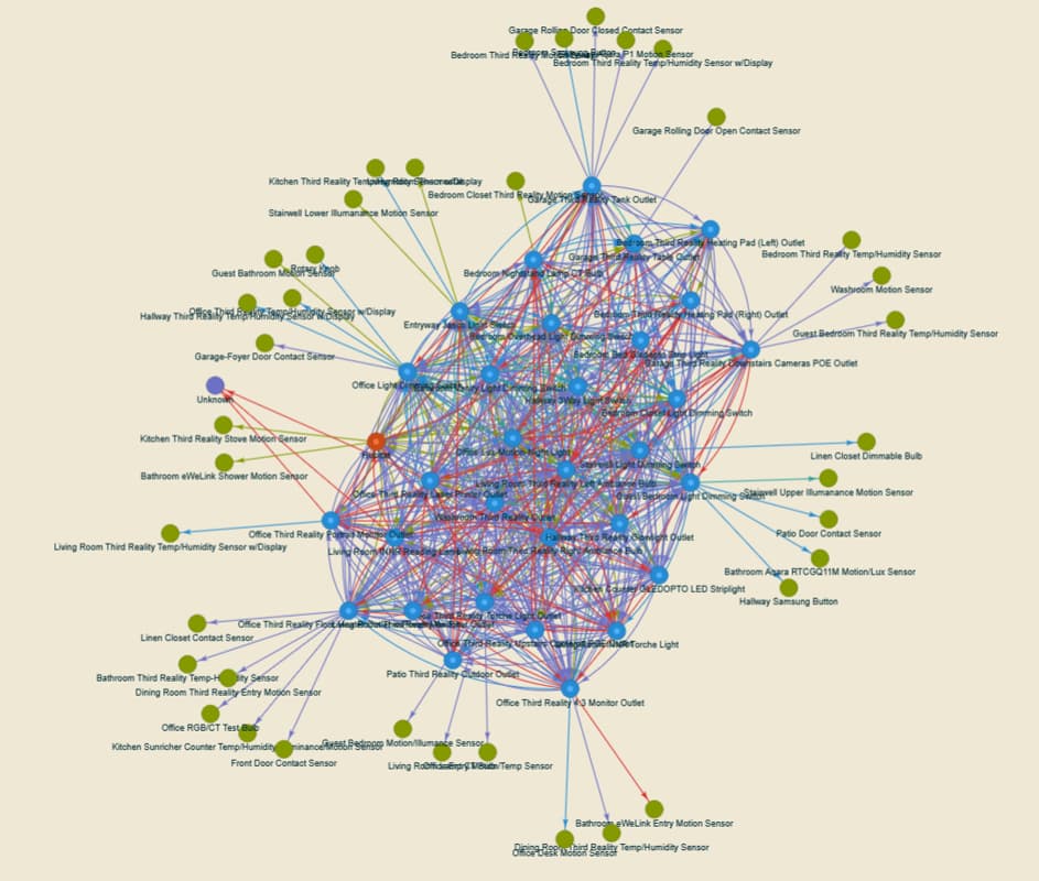

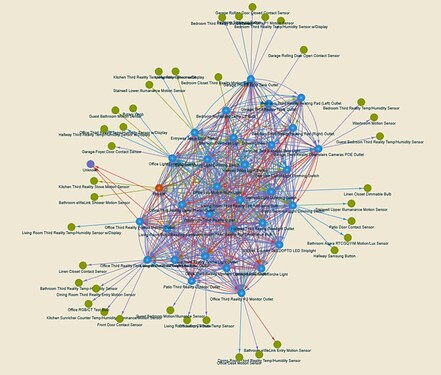

I wrote a journal of how I proceeded to repair it. Just not sure how to share that journal but it has some good stuff (I think) on tools and methods to recover.. My network now repaired:
(There is one 'unknown' device but I put it there purposefully)
If your interested in a document to read called "Hunting the Unknown:
Fixing a Broken Zigbee Network" please DM and I'll find a way to share.
