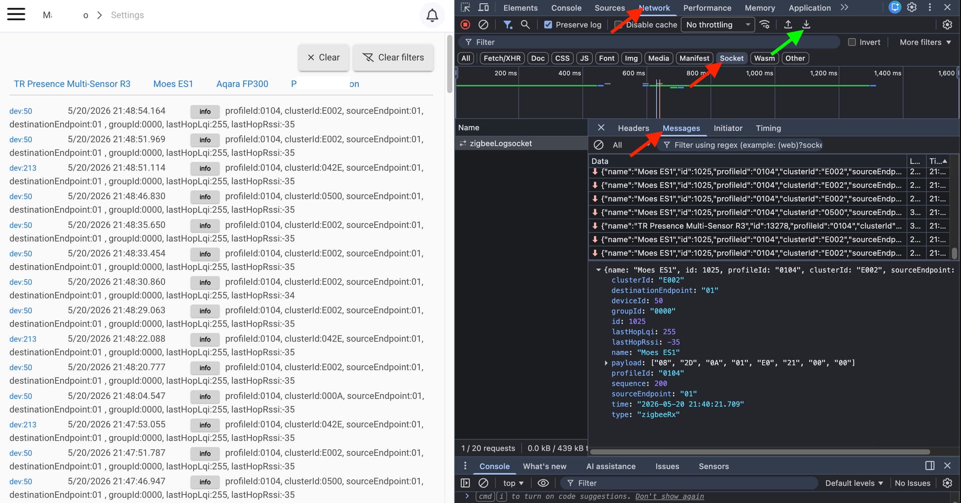

The HE hub provides a means to view/retrieve the complete stream of incoming Zigbee messages (as seen by the hub). You can see these directly on the hub admin interface at http://<hub ip>/hub/zigbeeLogs. It's possible to leave that browser tab open (and visible) and let it soak up logs for a while and copy/paste that into ChatGPT/Claude/Gemini. Ask a simple question as @neonturbo suggested above, with a summary description of the issue you are observing.
However what is rendered on that page is not as detailed as what the hub actually outputs on the websocket. To capture the full details, you need special tools, as a websocket connection is different from a web page. It is a little bit more technically involved; probably the easiest way is to use the developer console (F12) on the http://<hub ip>/hub/zigbeeLogs page, reload, and let it soak for a while.
Here is an example using Chrome:
The red arrows show where to navigate to. The green arrow points to the "export" button which lets you save the full capture to a ".har" file. You can upload that file directly to Claude/ChatGPT/Gemini.
Each log line has details about the Zigbee message received, including the full payload. AI tools are good at parsing these logs and figuring out what devices are doing and can even identify problems (e.g. Excessive OTA requests from Thirdreality devices).
