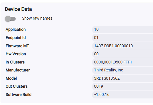

I have ThirdReality tilt sensor :

However, I do not observe any excessive OTA traffic / ZDO Match Descriptor Request messages ...
These are paired to my C-8 Pro, latest platform versions.
Will monitor these devices more closely in the next days
Thank you for looking into it. I also have a tilt sensor (3RDTS01056Z) like yours and multiple night lights (3RSNL02043Z) that do not exhibit the excessive OTA message behaviour.
