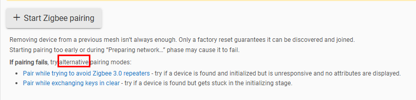

We have the alternative pairing modes - with my hub in normal place none of the 3 methods will finish - they often see a new device - initializing - but it never finishes - not even in the clear.

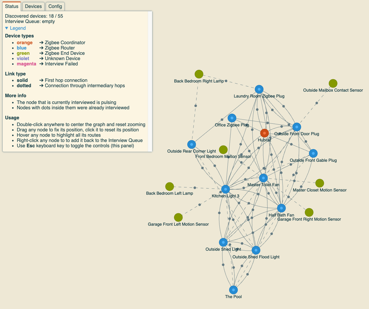

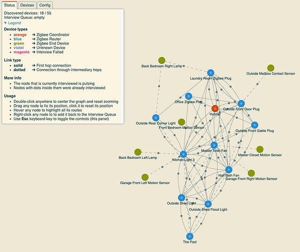

Interesting - the Neighbors Map shows all my devices. The lock in question top right - outside garage pedestrian door lock. Shows connection to garage light and the light shows connected to hub - i think.
The Route Map only has 18/55 devices discovered???
Is that normal?
