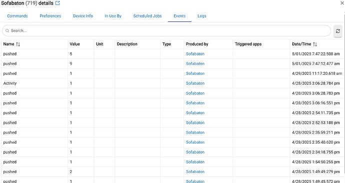

From the log...it's not happy with the on/off commands from the device...it appears to just send a numbered button push.
Somewhere I saw a comment about needing to add some device info to the driver...is there something I need to modify?
Level
Clear filters
dev:7192025-04-29 11:17:24.618 AM
error
org.codehaus.groovy.runtime.metaclass.MissingMethodExceptionNoStack: No signature of method: user_driver_hubitat_Sofabaton_X1S_1249.on() is applicable for argument types: () values:
dev:7192025-04-29 11:17:22.856 AM
error
org.codehaus.groovy.runtime.metaclass.MissingMethodExceptionNoStack: No signature of method: user_driver_hubitat_Sofabaton_X1S_1249.off() is applicable for argument types: () values:
dev:7192025-04-29 11:17:20.617 AM
info
Sofabaton Button 1 Pushed

Could this be an indication of something wrong on my Hubitat side. It's my understanding that the communication with SofaBaton is one way. I admit that's a guess from the little I know. In a post above of the EVENT tab for the device...I don't have all the same fields populating. It also never shows an on/off button push.
Does SofaBaton "return" the missing fields? THX!
