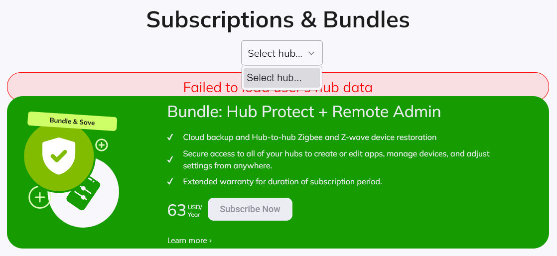

I tried to register my existing (old) hub by clicking subscriptions and it doesn't let me select my old hub
maybe I'm doing something wrong.
Did you try simply reloading (browser-button reload) that web page?
For as long as I can remember, every time I access it, it always gives me that same "Failed to load hub data" message, but a page reload always gets past that.

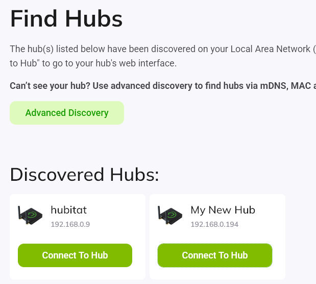

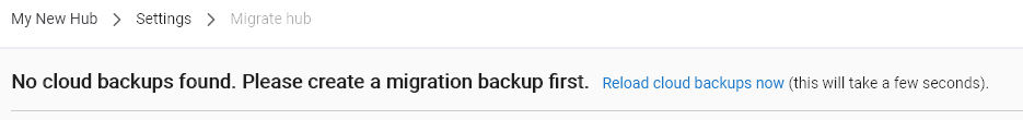

I did this registering the new hub with my existing login/password. When I click on setting->Hub Migration it cant find any cloud backups at all. I need to migrate my C7 data, and without that capability I have no use for this C8-Pro hub. If I need to purchase another cloud backup to make this work then I'm ready to do this.

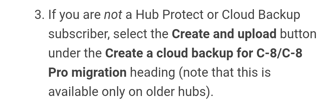

You do not need a subscription to migrate from older hub:
Be sure to check out this document: How to Migrate to a New Hub | Hubitat Documentation

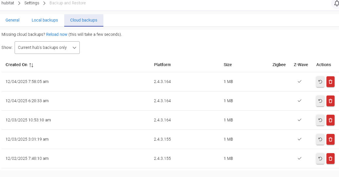

I can create cloud backup with my C7 with no limitation and create several yesterday and this morning. After disconnecting old C7 and with my C8P log into my existing account no backups show up.

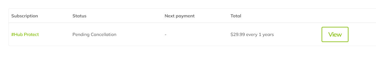

Is it because this shows up in my subscriptions:
Which hub is the above screenshot for?
That's really great news -- all these various improvements will obviously be a nice win for all subscription holders, but also welcome relief for you (no longer having to run manual interventions in all these cases, or at least a heckuva lot less)!
My old C7 hub

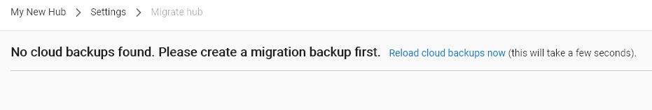

but in the new C8P just shows this:
Could this be the problem. Says none register (C7 hub) but I can save cloud backups.
