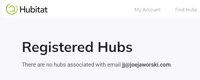

Yes, I am showing that your C-7 is registered with your Gmail account, but cannot see the new hub. Please register the new hub with same Gmail account. You do not have any hubs registered with joejaworski domain, as the above screenshot says.

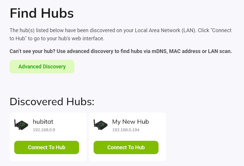

Download advanced port scanner. Likely your hub changed ip's. If it hasn't press the network reset button on the bottom of the hub for 7 seconds. It will be the only round hole out of all the square ones. Used advanced port scanner to find the new ip. If you can't get into it, try getting into yourhubip:8081

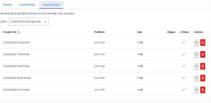

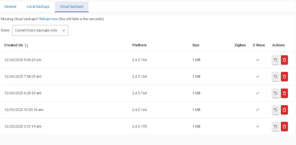

Here is a look at my c7 screens. Perhaps you can explain why in the newly purchase C8P it show no backup are available. Again, All these screens shots are from my c7 hub that has been running fine for several years. Do you spot anything wrong with any of these that would prevent the C8P from migrating. Perhaps the C8P shipped to me is defective,

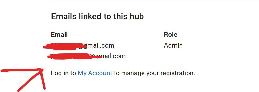

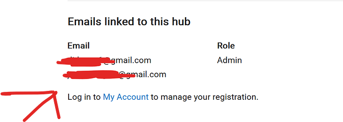

In your c7 and c8, go to settings>>Hub details. What does your emails linked area say?
That fixed it! the new and old hub had different email address! Thank you!

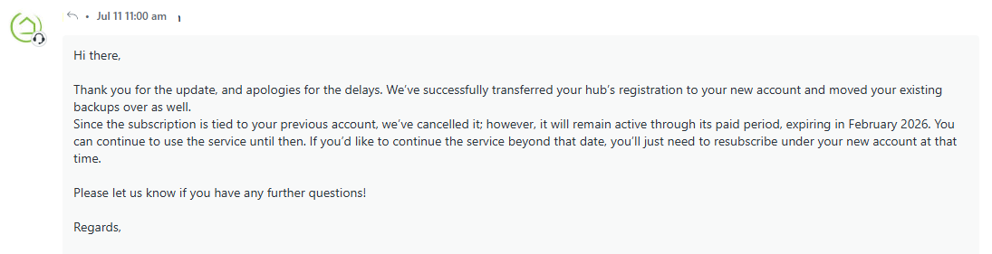

That is not what you asked us on June 7th. You wanted the C-7 hub to use the Gmail. Here is the last email we sent you:
If you'd like to change your hubs to your personal domain, you can do so from my.hubitat under Hub Details, using the replace admin feature. Please note that changing the admin to your personal domain will cause existing backups to not be shown. To be able to see the backups, both hubs must be registered with Gmail account. Once you migrate, you can then change the admin to your preferred account.
Thanks I must have miss that email. I will keep every the way it is right now.
