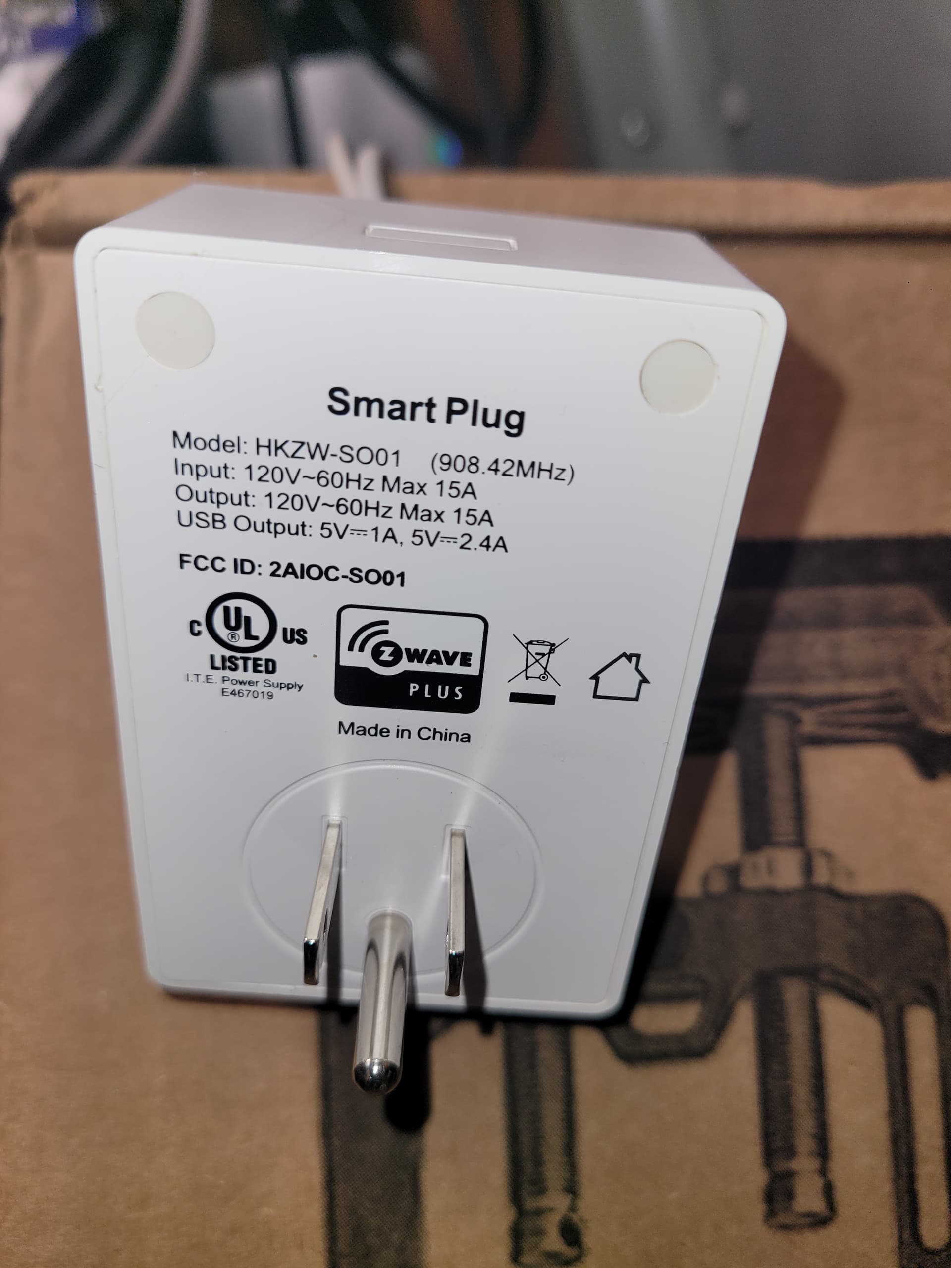

PS is it the square plug?
This one?
If so, it was finicky to pair but rock solid for years after.
I just paired that to my C-8 Pro.
No it is not one it is

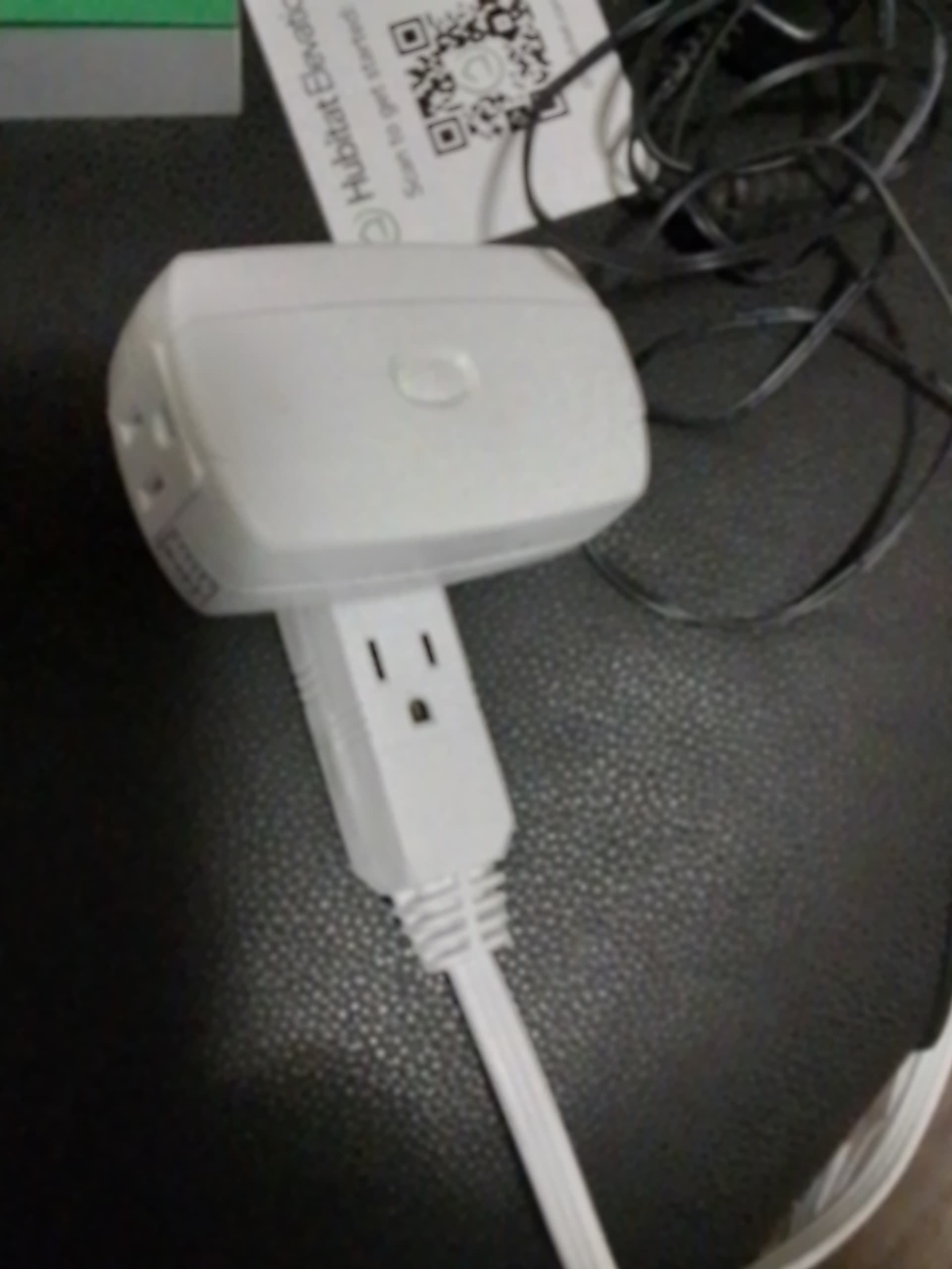

It is a monoprice p/n 11995 plug in switch.
That looks like a very early GE/Jasco Zwave plug.
Don't get frustrated with Hubitat -the issue is the plug. Excluding /re-pairing is insufficient for these for unknown reasons. You need to reset the thing, then try to pair with Hubitat. It will probably take numerous tries.
FWIW I have a few of these (a bit newer model). I ended up having to repair all my devices after an issue (subscribe to Hub Protect), and one of them re-paired fine after reset, and the other took me at least 20 attempts...
No it is definitely monoprice, maybe 3 years old.
There is no factory reset available for the device. It is listed as compatible in add devices, monoprice, plug-ins.

I think it is a rebranded GE/Jasco.
What is the model number of this monoprice device?
Don't know model isnt on the device or the manual but the part numbers is 11995
It's a rebranded Vision Security device (they were also sold by GE/Jasco as a 4101, Honeywell and others). Here is the manual:
If the reset does not work, try unplugging, then pressing the button for at least 30 seconds to drain out any residual power. Then to reset, press the button and hold; while holding, plug it into the outlet, and continue holding for more than the 10 seconds directed - try 15 or see if any lights flash.
Another post indicates these need load on them to reset - I'd try that last.
This is a later version of the device, but might help:
ETA: This might also help - similar but slightly different process - the exact process may depend upon which version of firmware yours have:
https://www.reddit.com/r/homeassistant/comments/1h62768/jasco_zw4101/
I tried the hold button while plugging in and nothing. Then in a fit of frustration i hit the button many times and it was almost immediately discovered and included. Who says banging on buttons doesn't help.
