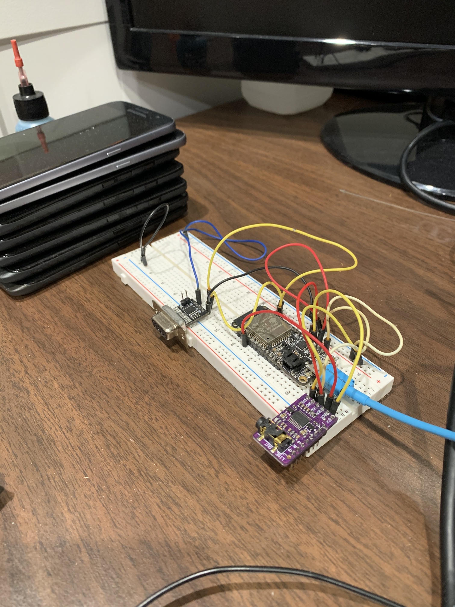

I couldn't get it to work so I set it aside for a bit. I have left it setup on a breadboard on my desk to taunt me.
I could get a pi with an usb/ftdi cable to work fine with the amp, but for some reason I can't get the esp to do so. If you have the arduino sketch that you got to work I would love to take a look.
I mostly just used the ESP WifiTelnetToSerial example in my code. From there I just kept modifying the code to try different things to get it to work and haven't got it going.
I am also using the ESP to do the TTS via a DAC and control a 12v relay to trigger the PA function on the amp. I will try some code with just the telnet/serial and drop all the TTS as that may be causing the issue.
