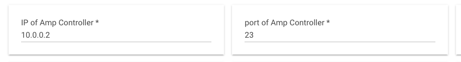

In your device driver, I entered the IP address as well as the port of the serial controller. This works great.

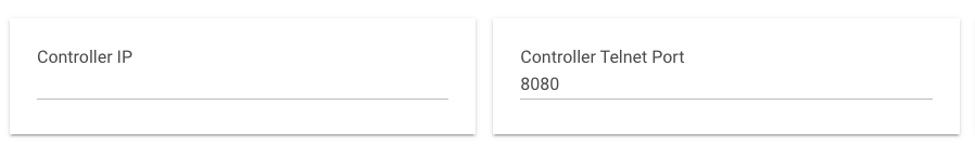

In the official driver, it looks like the below, but the port defaults to 8080. I changed 8080 to 23, which the port previously setup on the serial adapter. Any reason this would be wrong?
No matter what I try, I get "Offline" status using the official driver. And the logs show a telnet connection error. Is it possible I need to charge other parameters on the serial adapter?

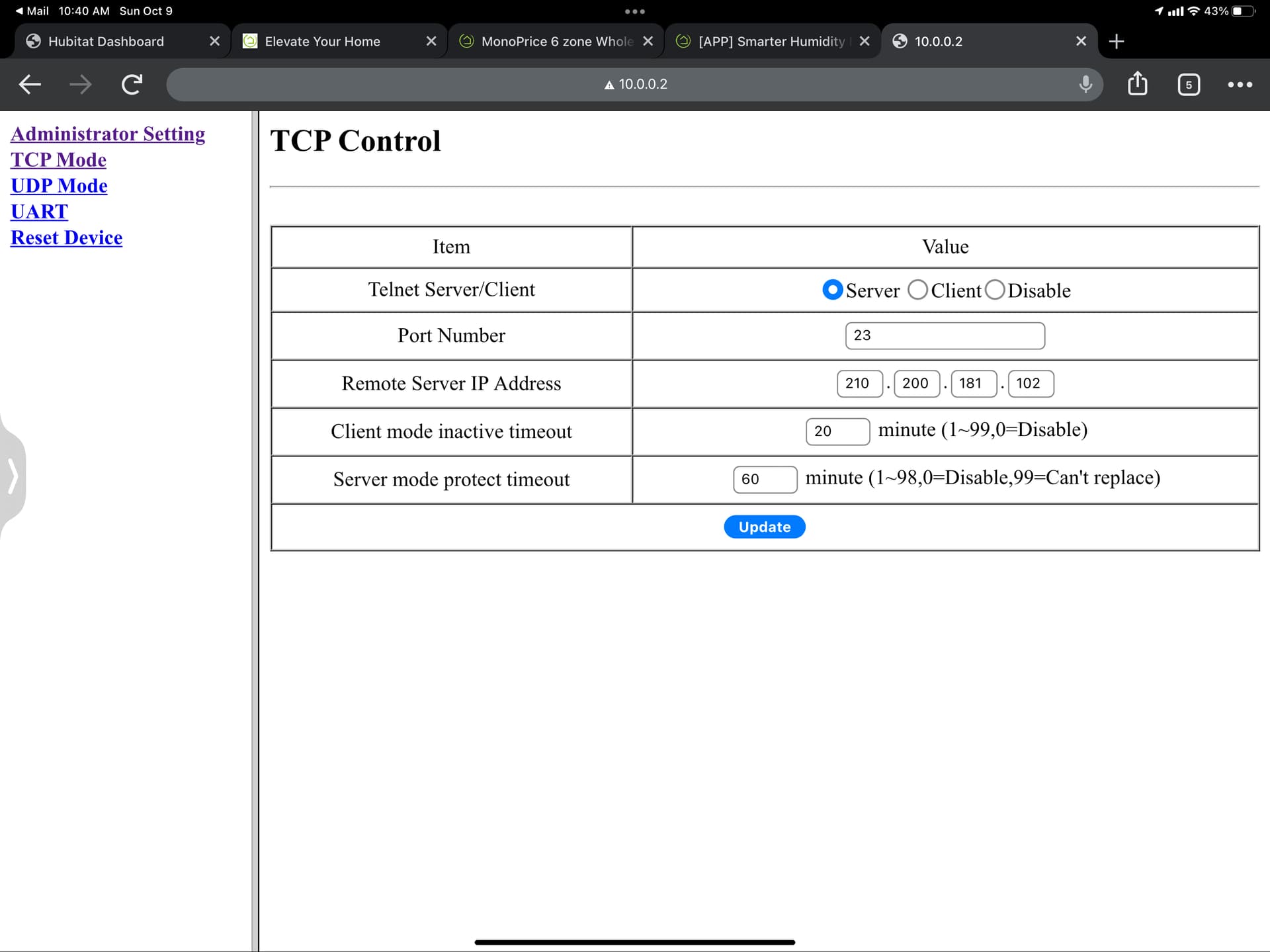

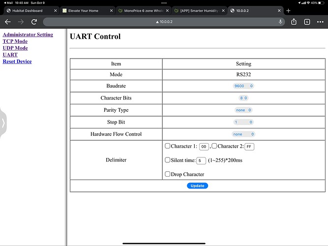

The driver use telnet too can you send an screen shot of the telenet to serial configuration screen?
Try to change the port on the serial to telnet adapter to 8080 that is what I have set on my.
Thanks Jorge. I’ll try the 8080 port. In the meantime, here are the main configuration screens from the serial adapter. Let me know your thoughts. Thank you!
Screen Shots

Turns out the official driver will work if you set the port to 8080, as @martinez.mp3 suggested. Thank you Jorge! Of course, I'm using the Monoprice 6 Amp not Preamp; that could be a difference, not sure. When my serial adapter was set to port 23, and I put 23 in the driver, the device was always offline. As soon as I used port 8080 in both places, everything worked (with one caveat below). Not sure why, but hopefully the tip helps others who are trying to make it work.

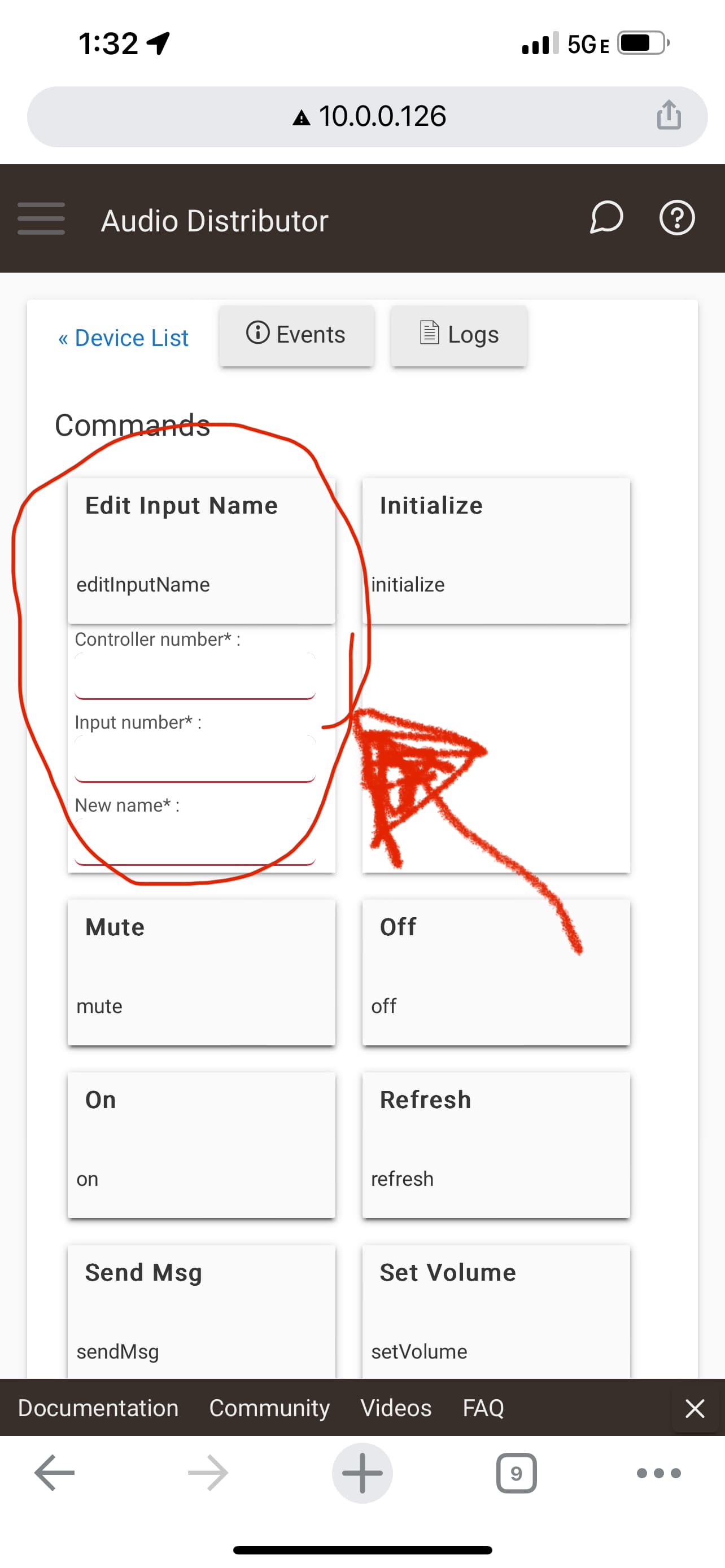

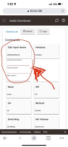

Can someone guide me on how to rename the sources to what they are (instead or RCA 1, to have it display as "Sonos" or "Chromecast"). I'm having trouble on my 3rd zone that I added to rename those sources.
If you go to the parent device, on the device details page, you’ll see a command called “Edit Input Name”. You can name your inputs there. It looks like this:

I tried this, but cant get it to work.
Is there a specific naming system I'm getting wrong.
For example, the 3rd zone on my 3rd unit, is that zone 15, or is zone 33 .. i've tried both without success. Thanks so much for the reply.. I'll keep at it, but if you know the correct form, I'd appreciate it.
