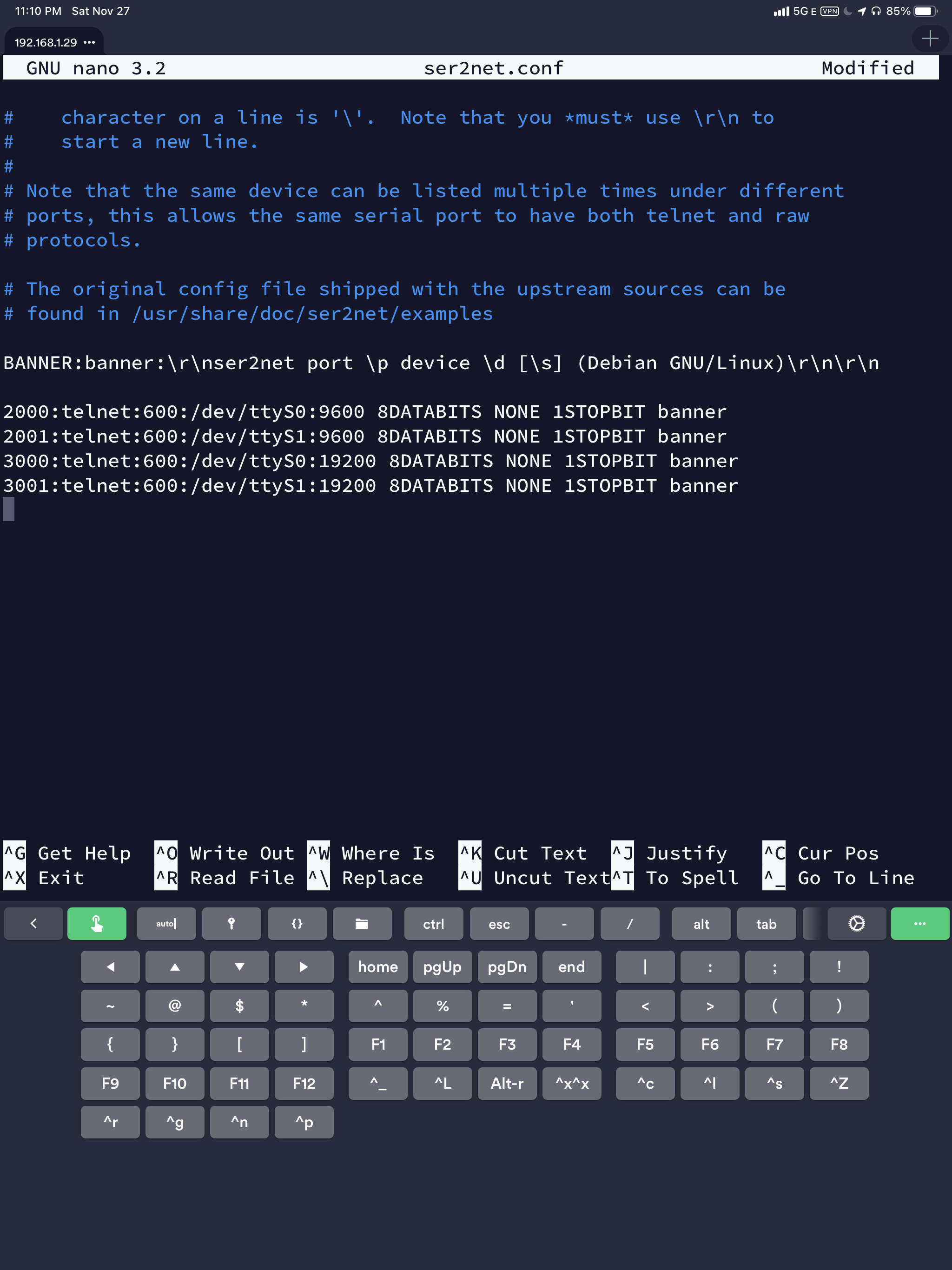

I looked up that file and found this:
I tried ports 2000, 2001, 3000, and 3001 on the parent device. Everyone produced a telnet error in HE:
dev:8352021-11-28 12:18:58.775 am warntelnet input stream closed
dev:8352021-11-28 12:18:58.762 am warntelnetStatus: error: receive error: Stream is closed
Any ideas? Is there some setup required to ser2net. I only see installation in the documentation. Where does the port get set?
