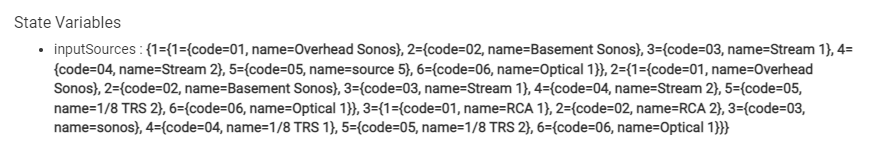

Got it.. I was trying to rename the inputs.. But I have 3 systems (soudavo master + 2 slaves).
I've been successful on my first 2 devices. But the 3rd doesn't seem to update (i might have just forgotten the correct naming syntax).
All the inputs are the same (i'm using the soundavo extenders), so I'd like them to read the same.
I've tried using Controller number 3, Input 1 , New name: sonos, and it simply won't update. I can try from scratch in case i screwed it up but am hoping not to have to do so.
Just got it work.. Thank you.. The key was clicking "save preferences" after each zone.. thank so much.. really wonderful driver.

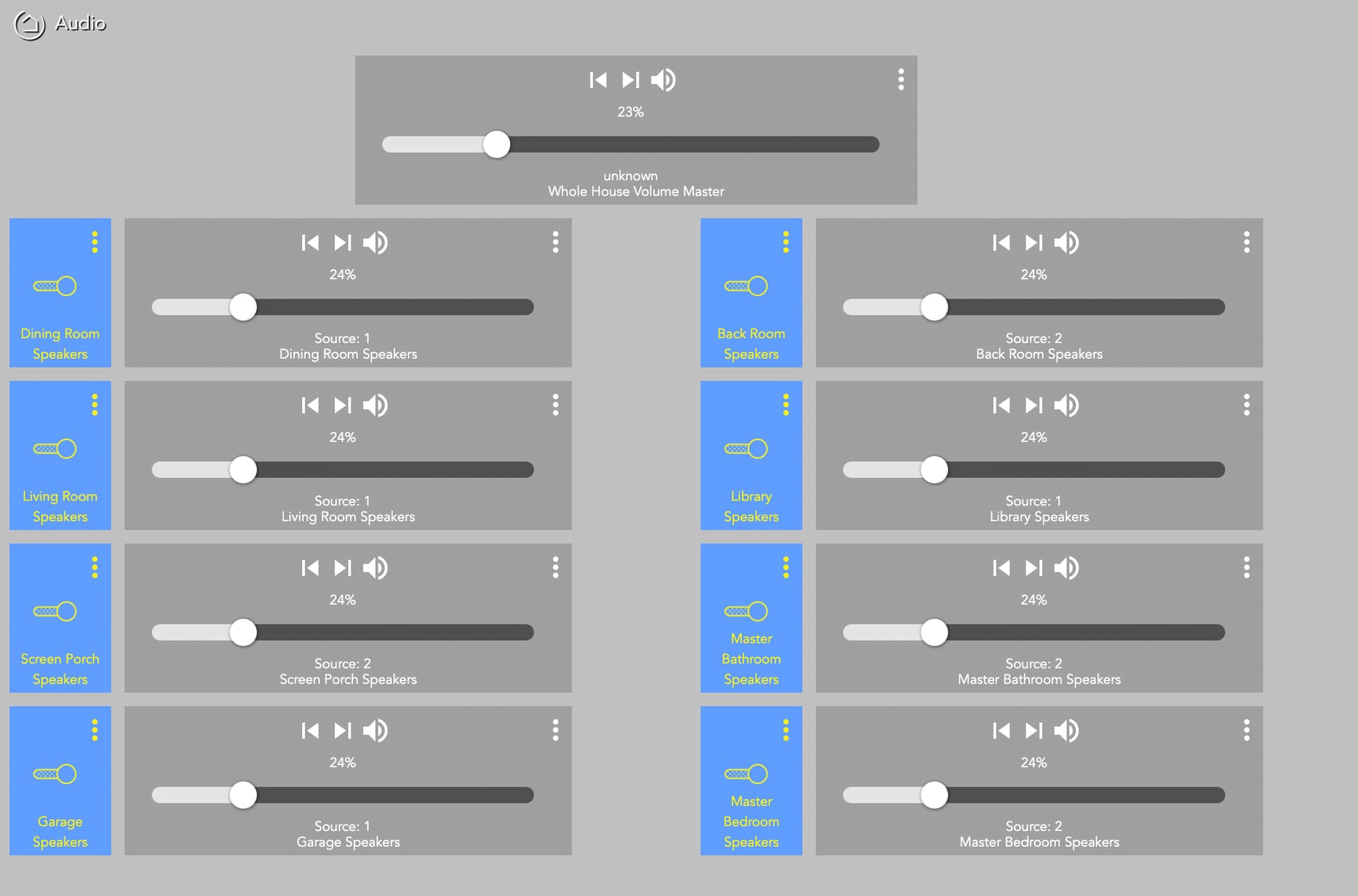

What are people doing for Dashboards with this? I just want a dashboard where I can set the volume, and the source for each zone. What's the best way to go about this?
As a side note, this thing has been alright. I've had it for almost 10 years. There is some bleed over between inputs... Like if I'm playing something in the basement on input 1, and I have a zone upstairs set to input 2, I can faintly hear it in the speakers. And I get some buzzing when no audio is playing but the zones are set to medium volume or higher.
Anyway, I just need to figure out dashboards. And then I need an automation that I can run to set everything back to where I want it after the power goes out because it doesn't remember.

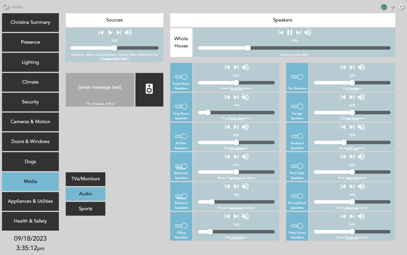

Here's what mine looks like -- boring, I know. It's just a media player tile for Sonos and then the same for each individual speaker device (the child devices created by the MonoPrice 6 driver). I also created a virtual speaker device for the whole house so that I can control all the individual speakers with one click.
There's also that grey box toward the left side of the dashboard a little ways down from the top. This is a place any member of the family can type in a brief message that will be played ad hoc from all the activated, unmuted speakers. This is handy when I'm traveling, urgently need to speak to someone at home, but the wife (or teenager!) isn't answering their mobile phone.
Again, nothing too sophisticated but it seems to meet our needs.
Yeah, this is awesome. I don't seem to have the Sonos templates though. Can you show a screenshot of the config for one of the widgets?
Ah, I found the music player template, that works fine. I haven't been using dashboards much, I use voice control for as much as I can...

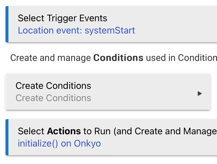

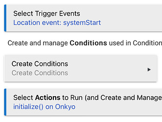

I noticed that my connection stops working to the audio controller sometimes, and the widgets can't control it anymore. If I reset the hubitat, or click Force Poll or Initialize, it fixes it.
No firewall between the controller and hubitat, and everything is wired ethernet.
I see the same thing on my Onkyo amp. Just today I added a rule that initializes the driver when the hub boots up.
Yeah, mine's not on reboot though. A reboot only fixes it. It's only after it's been running for a few days or so I think.
