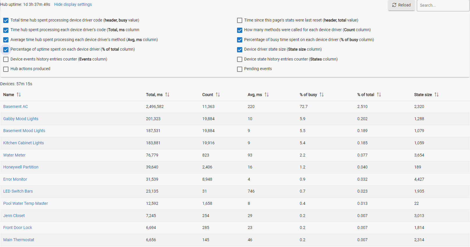

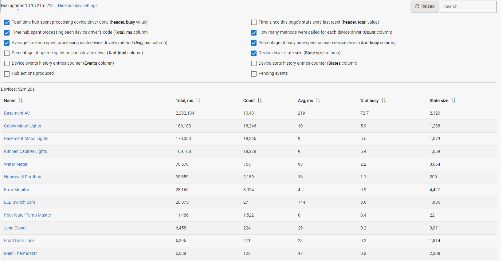

Recently started getting sever hub loads and noticed this with the basement AC. Any ideas what I should look at?
If you add the % of total column, what do those numbers look like?
This?
