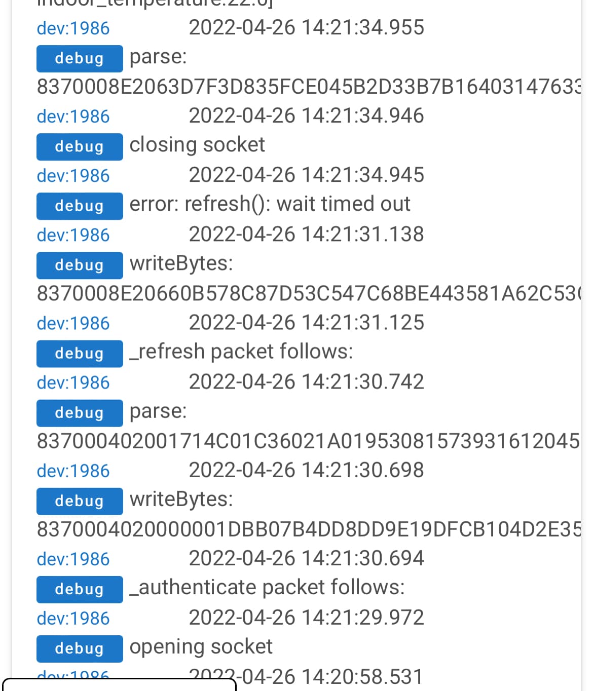

Maybe I read those too quickly, but it looks like it worked now? Seems like maybe a timing issue between the AC and HE that we'll have to track down if turning on debugging made it work.
The message comes up periodically. Sometimes not for hours.
Ah, thanks for clarifying. I didn't realize it was an intermittent issue.
That definitely points to a timing issue -- this uses the rawsocket interface, which is asynchronous and does not have the sort of built-in retries that a protocol like TCP/IP has. So, if either side (HE or the AC) sends a message and the other misses it for some reason, then it is just lost.
The timeout you are seeing is based on a 4 second timeout value that I set for the responses back from the AC after an HE request. This value was based on empirical results from other systems. That feels like an eternity to wait, but maybe yours is just experiencing occasional hiccups that cause it to take longer. Or if the AC drops from the network periodically and never sees the request in the first place then this could happen.
It's hard to tell which of those cases is happening. If you leave debugging on and can share a log of what happens before and after the "wait timed out" message we may be able to deduce what is going on. But it may be difficult or impossible to actually fix, so if it seems to be working otherwise then an occasional error print may be innocuous.
Ill keep the debug on. So far, its been almost an hour and no error.
Interesting...do all of the failures look like that (_authenticate works, _refresh fails)? Maybe it is going too fast from one to the next. I'll hit you up on PM with some customized code to try to track it down.
Looking over my log history. I also have this [error: refresh(): wait timed out] message but only one or twice a day.
Going through the last hour or so I have like 5 and they all follow the refresh. Authentication always seems to work.
