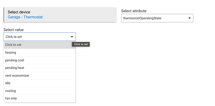

@tomw : Really dumb question: How do tell if the Midea AC Controller is on or off in a rule?
I looked at Thermostat > Thermostat State and see several states, except off.
I then look at Custom Attribute >ThermostatOperatingState, and too do not see off as option.
However, when I look at the device, I see under current states "themostatOperatingState: off".
The only RM5 thing I see that gets close is Thermostat Mode, which has an "off" choice, but it never evaluates to off regardless if the AC is running or not.
I appreciate the help / I know I am missing something really small.

BTW, how do you tell in a rule if the unit is off (more details in my previous post)? I feel I am missing something really simple.

I read through the thread and an unclear of the work-around to tell if the unit is on or off. Could you tell me what is working for you -- namely, how to tell in a Rule if the Midea unit is actually on or off?
I saw the discussion of "thermostatOperatingState" showing either on/off on the device, but that's not supported by the rule machine. Another said to use the RM5 ThermostatMode; however, it returns whatever was last used -- and not if the unit is on or off.

Same here. I've changed line 575 in the driver to:
events += [name: "thermostatMode", value: resp.power_state == "off" ? "off" : translateMode(resp.operational_mode?.toInteger(), "integer")]
I'll post back after I've tested this for a while.
Line 576 is incorrect I believe, as "on" and "off" are not permissible values for thermostatOperatingState as listed here: Driver Capability List | Hubitat Documentation
